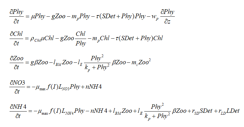

1. I want to know equation of fennel model in ROMS, where is BIO advection term
BIO equation according to fennel et al. 2006
(I express partial derivative is 'P' and total derivative is 'D' in this topic.)
for instance,
PChl/Pt = rho*mu*Chl - g*Zoo*Chl/Phy - ... - tau*(SDet+Phy)*Chl = sink and source term : time rate of change
therefore,
DChl/Dt = (1)PChl/Pt + (2)u*PChl/Px + (2)v*PChl/Py + (2)w*PChl/Pz
(1)time rate of change (2)advection
is right?
제목 없음.png (16.91 KiB) Viewed 19362 times

All the Fennel tracers are advected in pre_step3d.F and step3d_t.F when T and S are advected. Same with diffusion. The loops go over 1,NT(ng) where NT is the total number of tracers, including passive tracers and the bio tracers.
