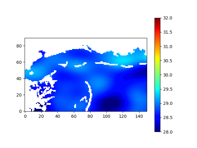

I have been working on developing a circulation model for my area. I've managed to get the model running, but I'm getting strange strip artifacts in my model output. In addition, I'm not sure if my boundaries are behaving properly either. You can see as it spins up that there are not the strange line artifacts, but once it gets going they appear. Some are vertical and some are horizontal. Here is the first few days of the model run, note that the color bar temperature range is only 4 ºC as it is summer:
model animation
model animation
At the advice of a fellow ROMS modeler I tried using the default centered advection of momentum setting, but the problem still remains. Has anyone seen what is going on here?

Did you switch from U3 advection to C4 advection of tracers without adding any diffusion? The U3 advection has implicit diffusion - you'll need either that or some explicit diffusion. As for the OBCs, are your boundary values warmer than your initial conditions? If so, I'd expect what you are seeing. Is this surface temperature?

Great. Thanks for the help. I did not explicitly add diffusion after removing U3 advection. I will try that. As this is late spring, it is sensible that the offshore waters would be warmer, so it is good to know that the boundaries might be behaving properly. This is a map of surface temperature. I will try to add in diffusion and see if that helps. Thanks.
