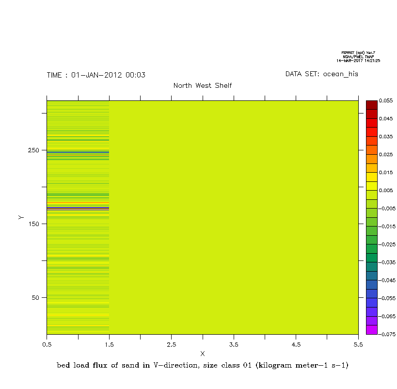

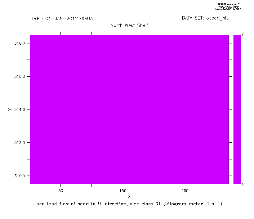

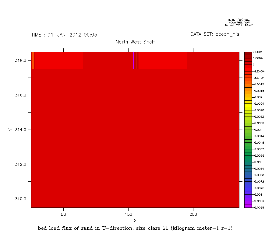

Only bedldu along N and S and bedldv along E and W boundaries have issues (I showed bedldu along the northern boundary and bedldv along the western boundary after and before my fix in attached figures).

- bedldv along western boundary after modif
- bdc_w_bedldv_after.gif (7.13 KiB) Viewed 4298 times
- bedldu along northern boundary after modif
- bdc_n_bedldu_after.gif (7.2 KiB) Viewed 4298 times
- bedldv along western boundary before modif
- bdc_w_bedldv.gif (11.59 KiB) Viewed 4298 times
