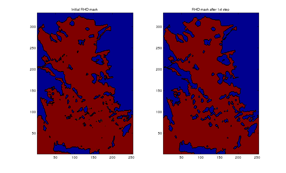

I also use PERFECT_RESTART option and I notice that my
mask at rho points is altering/changing. I have already check

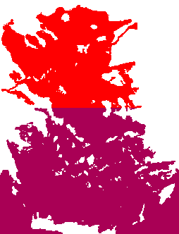

Hi Kate
I am setting it through the wtype_grid
variable in my grid file. I had already used
the same grid with MY25 and GLS with
SOLAR_SOURCE and WTYPE_GRID options and
the model run without any problem.
I am attaching a figure with my wtype_grid
variable to see it.

Re: Surface and Bottom Boundary Layer combination
I think you need to give it a well-behaved value inside the land mask.
Kate you are absolutely right. I change the values of
land - just set 2 and 3 all over the grid
- and the model run without blowing up. But I am still
curious. Why that happened with LMD and not with the
other schemes. Once more, many thanks Kate.
