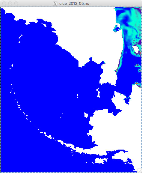

Congelation ice growth in May, metroms.

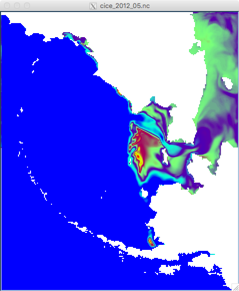

Congelation ice growth in May, fake coupler

Hi Kate, that's interesting about the congelation. I don't have an alternate coupling setup to compare my runs to, but for what it's worth my annually averaged congelation values are generally around 0.2-0.3, with the exception of right at the coast where they are around 1 (up to 1.4). I *think* that's ok for the Antarctic....We can chat about it in Hobart, but for now enjoy NZ! I'm impressed you found some internet there!
Just for the purposes of organising my brain, and in the hopes that someone with extensive knowledge of advection schemes sees this, I have some more information about my crazy sea ice. It looks like TS_U3HADVECTION/TS_C4VADVECTION is still producing spurious supercooling, although not as much as TS_C4HADVECTION/TS_C4VADVECTION or TS_A4HADVECTION/TS_A4VADVECTION. As a test I ran with TS_MPDATA, which is the only guaranteed monotone advection scheme as far as I understand, for 84 days before it blew up. Ben has also had issues with MPDATA's stability, but I reckoned it would at least provide a benchmark for the first few months.

Just got access to HSIMT, and confirmation that it is okay with negative temperatures. I will try that today or tomorrow. However, I don't think my issues are due to advection anymore. That would show up in the frazil fields which are very low in the Ross and Weddell. Instead the ice there is getting very thick due to congelation. I keep going back and forth as to whether I think it's a thermodynamics issue (ice forming too fast) or a dynamics issue (ice not being exported fast enough). So HSIMT will hopefully clear up the last few advection errors I'm getting (I see a few in the Amundsen Sea, and out the near the northernmost extent of the sea ice) but I don't expect it to drastically change my solution.
With regards to GitLab, I have my own branch including ice shelf thermodynamics, but I am keeping an eye on the GitHub updates to make sure I don't miss anything important.
And with regards to the periodic boundary/domain sizes, that caused some problems earlier (off by one errors in the coupling code wherever there is a periodic boundary) but they are all fixed now. I have the same number of points in my ROMS rho-grid as in the CICE grid. My CICE input grid file is for the CICE u-grid, which corresponds to the ROMS psi-grid, but you have to extrapolate one extra row and column to make it the right size. The CICE code calculates the t-grid at runtime which is the same as the ROMS rho-grid. I'm happy to share my code if you're interested, Kate.

Thanks Hui for your message. Yes, as we discussed over email, I was getting more advection errors with A4 + strong diffusion than I realised. Switching to HSIMT removed the weird "corner" of sea ice in the Ross Sea, and there is thinner sea ice in the outer Weddell Sea now too. I am currently running standardised experiments with the different advection schemes to try to quantify this difference. But I think I will stick with HSIMT.
Thanks for the explanation of HSMIT around rough topography. If there were errors occurring due to this phenomenon, what sort of warning signs should I look for? I assume there would be no spurious supercooling since HSIMT is monotone.
Since there is (correctly) less sea ice with HSIMT, the Cosmonaut Polynya keeps swallowing up everything after a few years, and even wrapping around East Antarctica. I think there is a dynamics issue preventing sea ice from exporting away from the coast, so it doesn't melt far enough away from the coast and this missing freshwater is leading to destabilisation of the water column, upwelling of CDW, the usual story. I'm working on it...but fixing the advection errors is a good first step.
