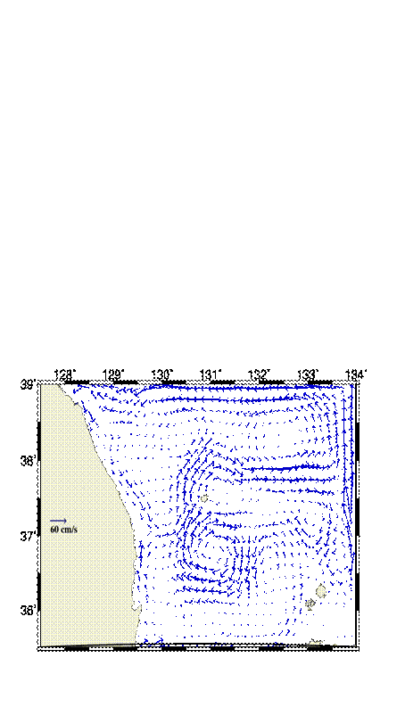

i have some problems. When i run the ROMS model, the currets flow along the boundary.
As time passed, the results varied as follows :
사본 -그림1.gif (13.25 KiB) Viewed 10560 times
It seems the current can't go out the northern and eastern boundaris.
I hope that outflow is much stronger than now.
The model region is east/japan sea.
Please help me.

You haven't told us anything about what boundary conditions you are using. Do they need external values? If so, where are those coming from and do they look reasonable?

I used HYCOM data for boundary condition and initial data.
The boundary condition applied every 1 day.
Usually, currents in the north region flow easternward. However, my result showed converse.

What values of LBC are you using?

#5 Unread post by kobl1201 »
Hi Kate
I set up the model like this.
ocean_ub_3k_new.in
(117.57 KiB) Downloaded 995 times
I ,also applied relaxation method and sponge layer.
However, this methods didn't slove this problems

#6 Unread post by kate »
   LBC(isFsur) ==   Clo     Cha     Cha     Cha \         ! free-surface
                    Nes     Nes     Nes     Nes
   LBC(isUbar) ==   Clo     Fla     Fla     Fla \        ! 2D U-momentum
                    Nes     Nes     Nes     Nes
Perhaps try again without the "! free-surface" and other such comments? These comments in continued lines can confuse ROMS.

#7 Unread post by moritz.wandres »
I had a lot of boundary currents like this in the beginning which were essentially due to erroneous boundary forcing. Also I noticed you had -
M2NUDG == 0.0d0 ! days
M3NUDG == 0.0d0 ! days
Have you tried playing around with the nudging parameters?

Hello ~
i removed things such as !free-surface and then modified M2NUDG == 0.0d0 ! days, M3NUDG == 0.0d0 ! days. However, the results still showed same things.
Do you have other ideas??
