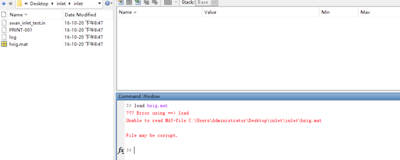

Recently, in order to couple the SWAN model, I have run the inlet-test case successfully, but when I use matlab to check the output files of SWAN, such as hsig.mat, fric.mat and so on , I found cannot open them. The attachment are my .in , log ,print file and hsig.mat. Can you tell me the reason? if there are some thing wrong with my swan_inlet_test.in. Thanks very much!

are you using Rutgers version of swan coupling or COAWST?
In the past, this error was due to a byte offset needed for matlab, and it depending on the compiler. So we have added some flags , such as
in Compilers/CYGWIN-ifort.mk
ifdef USE_SWAN
FFLAGS += /noextend_source -assume:byterecl
endif
what compiler are you using?
ifdef USE_SWAN
endif

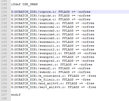

Thanks John, I use the Linux-ifort.mk, Could you mind show me how to add the flags?

to the Compilers/Linux-ifort.mk, you will need to add
ifdef USE_SWAN
FFLAGS += -assume byterecl
endif
i would suggest that if you intend on doing a lot of research with swan+roms, that you switch to coawst. We have updated swan to more recent versions, include vortex force wave effects on currents, have swan with grid refinement, coupling with refinement to roms, etc etc. We are up to date with Rutgers version of roms, so there is no difference there.
-john

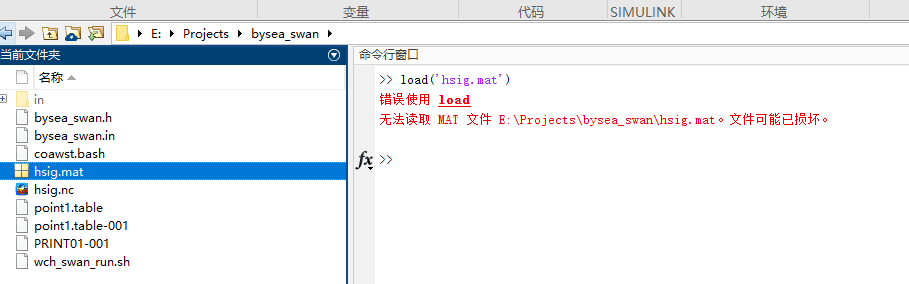

This problem occurs again when I run the Inlet_test case of COAWST. The MAT result output by SWAN cannot be opened using MATLAB. This time, I use the gfortran compiler. What should I do to modify linux-gfortran.mk??
chenghao
- 770E8DEF18D6EBDFD81E62F37A788900.png (8.85 KiB) Viewed 25950 times
Re: output files of SWAN model
i think for some versions of gfortran you need to add
FFLAGS += -fconvert=big-endian
see if that works.
what do you get for
gfortran --version
see if that works.
what do you get for
gfortran --version
