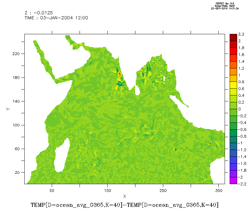

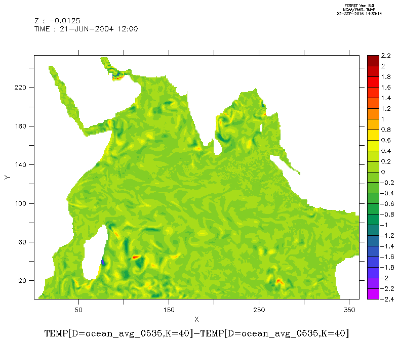

I am running ROMS model with 2003 initial conditions upto 2008.
There is large difference between outputs of this two runs.
After 2 months SST difference is +/- 0.5 degree but after 2 years +/- 2 degree.
Please see the attached plots of SST_difference.
Can anyone explain me the reason for this. How to avoid or reduce this error.

Re: Running ROMS Job with different number of nodes/processo
This sort of thing can lead to hours of entertainment.
I wouldn't try to debug this with a two-year simulation. Rather, run for ten timesteps, saving history output each step. Do this for two different tilings, maybe 1x4 vs 4x1. Run ncdiff on the outputs to see what changes first. Then resort to print statements at the i,j location(s) that appear in the diffs or else run two duelling debuggers.
Hopefully/probably Kate's approach will help you solve it. But I'm also wondering what sort of dynamics you are using. Can you post the cppdefs? Also, what are the values of Lm, Mm, and N? Ad do you mean by "SST difference"? PS the 16x16 solution looks to be going mentally unstable or something. Or maybe that's just me.
