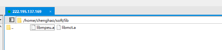

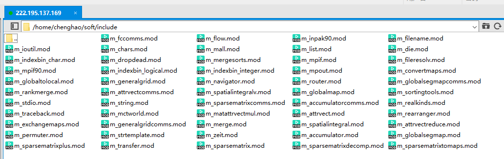

Thanks your answer, and I checked my path, you mean I did't compile the MCT rightly?

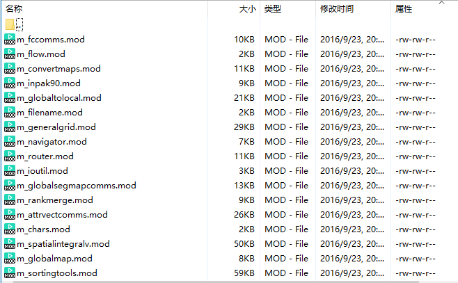

do you have correct permissions on those mod files?

this is my log file, and permission.
