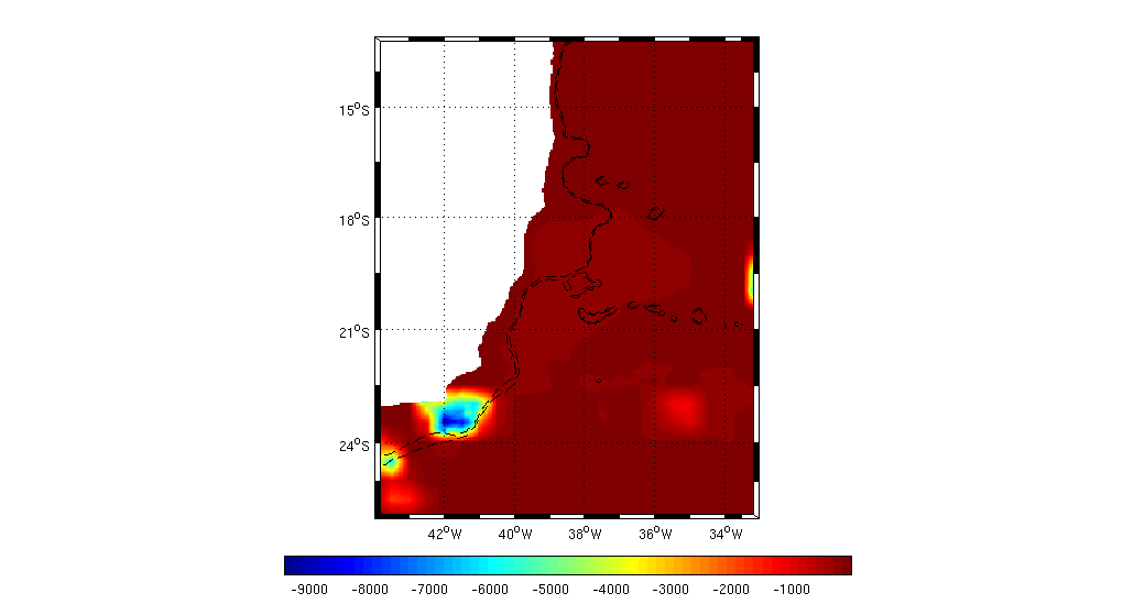

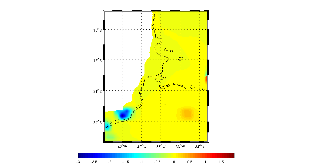

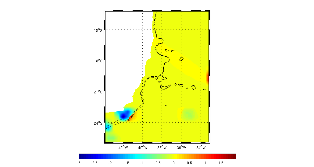

As I said, the wind-stress and surface net heat flux are not correct, I have attached the results of the first 6 hours of u-stress, v-stress and net heat flux. If I calculate the surface net heat flux by myself and #undef BULK_FLUXES, the model works, but I get some unrealistically warm sea surface temperatures, especially in shallow waters. I would like to use bulk fluxes.
I have checked the values of my variables and they seem ok. For the first 30 days my lwrad_down values are positive (min 309.5127 and max 439.5502), as well swrad (min 0 and max 723.3712).
The main part of my log file is attached.

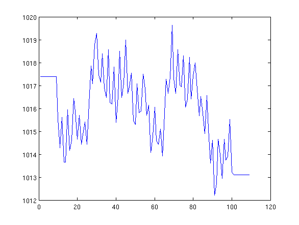

I think that my air pressure is ok, I attached a figure showing the time serie of the first 30 days (6h-6h) in a point located in a specific local in the open ocean (max value is 1029.7; min value is 1004.2).
I have no ideia what is causing my problem, any tip is welcome.
Thank you so much!

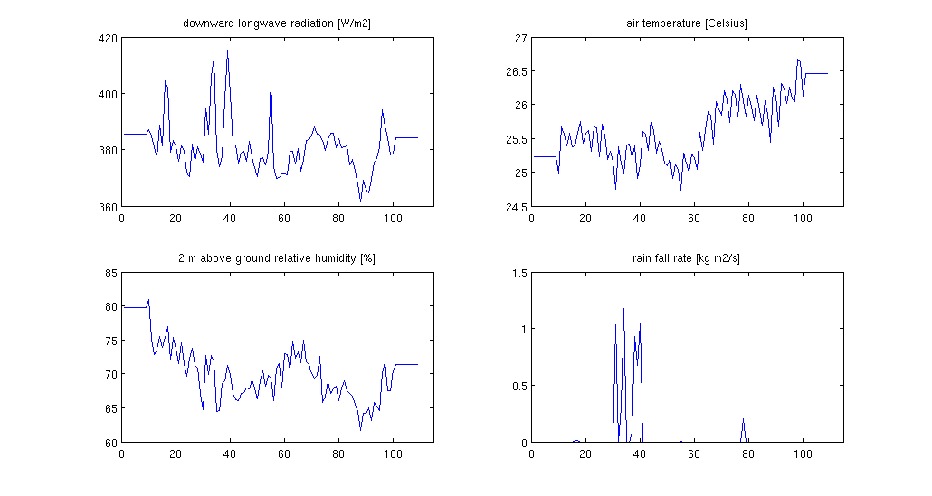

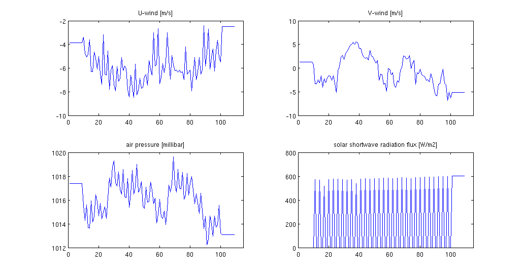

In order to facilitate the understanding of my input data, I have selected a point in the deep ocean (-37.792; -15.138) to show the time series of all my input data requested by ROMS in the simulating using BULK_FLUXES option, as I showed in my first post. I attached two plots of them.
About the values, I have selected the maximum and minimun of the firts 30 days (6h-6h):
- u_wind: max 11.123; min -14.834 [m/s];
- v_wind: max 13.199; min -16.227 [m/s];
- lwrad_down: max 439.55; min 309.51 [w/m2];
- swrad: max 723.37; min 0 [w/m2];
- Pair: max 1029.7; min 1004.2 [millibar];
- Qair: max 100.18; min 33.518 [%];
- Rain: max 10.728; min 0 [kg m2/s];
- Tair: max 33.107; min 17.469 [Celsius];
Are my input data wrong?
I don't understand why the experiment's results are showing wrong values and blowing up when I choose the BULK_FLUXES option.
Any advice is welcome.
Thanks in advance.

Re: Blowing-up problem: Bulk_fluxes
One odd thing I see in your configuration (by reading the log file) is that you have set DIURNAL_SRFLUX but you are using 6-hourly swrad. This is a contradiction.
DIURNAL_SRFLUX is designed to take daily average net shortwave and modulate that over the course of a day using the analytical diurnal cycle for each cell's lon, lat and year-day.
I'm not sure how the error of modulating an already resolved diurnal cycle will manifest itself, but it could be that noon time shortwave in the input netcdf data is being significantly amplified by the local modulation. But I would expect this to cause trouble everywhere.
You might #undef DIURNAL_SRFLUX and see what impact that has.
Are you sure your rain fall units are correct? You list rain fall as kg m2/s, but ROMS wants rain as kg m-2 s-1 (unless you have some conversion in varinfo.dat as Kate pointed out).
If I'm reading your time history plot correctly, you have rain fall rates at times on the order of 1 kg m2/s. If ROMS is reading that as 1 kg m-2 s-1, that's going to be massive (~86 m/day if I did the math right).
Thank you so much, your suggestion about the rain fall solved my problem.
Actually, my rain fall input data were wrong, they were in mm/day, and not in kg m-2 s-1.
My experiment is going very well.
Thank you again.
