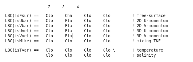

HELLO, I am going to run roms in a domain with one open boundary(in south) in tidal region for first time.I have made a ROMS netcdf forcing file, using OSU Tidal Data Prediction Software(OTPS). when I closed every bounary, the model run successfully, but when I open the south boundary, a problem had happened.

First, Flather is only a barotropic option, not an option for baroclinic velocities. I don't know if that caused your problem or not.

Thank you Kate, but I don't know which Lateral Boundary Condition Types that I should change 'Fla' to, after the generation of the grid, I just want to add the tidal forcing file to see the variation of water level, and draw the cotidal lines. I didn't want to think about the changes of temperature and salinity.

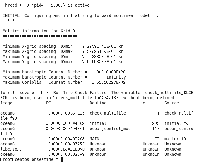

I set '#undef SOLVE3D' in my *.h file, and set Time-Stepping parameters 'NDTFAST == 0' in my *.in file, but it doesn't work. Then I recompile with USE_DEBUG turned on and rerun.

You're getting a error in check_multifile.f90, which handles the processing of the list of forcing files. This says to me there is something wrong with that list or one of the files in it.
Check that you have the correct NNFILES parameter, and that you have followed the instructions for the syntax for the list.
On open boundary conditions, for a start just use Rad for Uvel,Vel,TKE,Tvar. (Cha for Fsur and Fla for Ubar,Vbar).

Not only do you know that the crash occurs in check_multifile, you know that it involves a variable called check_multifile_$LCHECK (which I think is a local or module level variable called lcheck in the scope of check_multifile) being used at line 74 without a value being set.
Time to employ the magic trick of adding a suitable print statement just before this line, recompiling and rerunning. Repeat as necessary. Think about where lcheck is supposed to be set, and why this isn't happening in your case.
Since this code has been run by many people without this problem, it is probably a matter of malformed input as Kate and John suggest. Check whether your input is correct for the particular version of the code you have, eg. there are ROMS versions that require you to specify the number of boundary or climatology files and others that don't. Another trap for the unwary is the presence of non-space characters like tabs in the input, though I don't think this is the problem here.

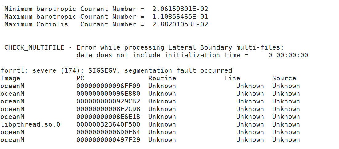

Thanks all your kind answer and suggestion, I got a feedback about CHECK_MULTIFILE, could you mind tell me how to deal with the initialization time.Attachment are my *.h and *.in files, if my cpp options are wrong.

What times do you have in your boundary file? What time do you want your initial time to be?

What that did was turn off reading your boundary conditions file and use the analytical default (which is zero), so though the model runs it's not using the data you wanted it do.I change "define ADD_M2OBC" into "define ANA_M2OBC" in my *h file and the model can run successfully
The CHECK_MULTIFILE error is saying that the time in your initial conditions file (reported as 0:00) is not spanned by the times in your boundary conditions files. All times (ocean_time, bry_time) have to use the same time base ("days since ....") so just check that the boundary times in the netcdf file are monotonic and bracket 0. (This does not appear to be anything to do with .h and .in).

Thank you wilkin,Here is the situation, I didn't prepare boundary conditions files, I have a grid.nc and a tidal-forceing.nc, just run the model with only tidal force. In this case, I can't change the *h file into this?

That will do what you want. What happened in your case was that:# define SSH_TIDES
# define ANA_FSOBC
* You defined ADD_FSOBC: this tells ROMS it needs information on zeta_north etc.
* The default, with no other instruction, is for ROMS to attempt to acquire zeta_north etc. from the boundary conditions netcdf files.
* ROMS searched your boundary condition file (which only has tide information) for zeta_north, was unsuccessful, and gave you the admittedly unhelpful error message from "check_multifile." The particular error was probably thrown because a tides file has no time coordinate variable, so ROMS got messed up trying to find the time that corresponds to initial conditions.
* You then defined ANA_FSOBC, which tells ROMS not to read zeta_north etc. from the boundary condition file but instead compute it inside analytical.F by including the Functional ana_fsobc.h.
