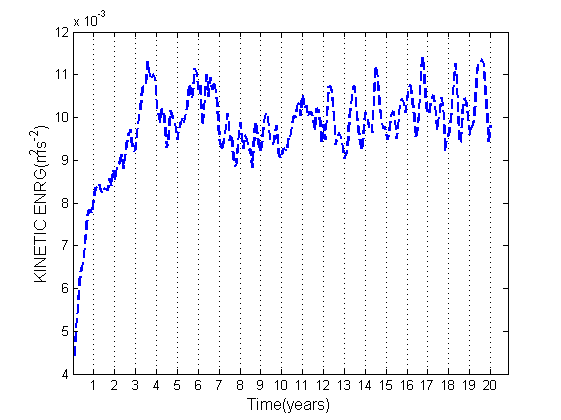

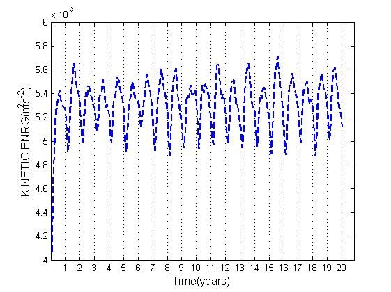

I have some questions about open boundary conditions and climatology fields. Now, I have two cases.
The first one, I set the *.in file like this:
LBC(isFsur) == Cha Cha Cha Cha ! free-surface
LBC(isUbar) == Fla Fla Fla Fla ! 2D U-momentum
LBC(isVbar) == Fla Fla Fla Fla ! 2D V-momentum
LBC(isUvel) == RadNud RadNud RadNud RadNud ! 3D U-momentum
LBC(isVvel) == RadNud RadNud RadNud RadNud ! 3D V-momentum
LBC(isMtke) == Rad Rad Rad Rad ! mixing TKE
LBC(isTvar) == RadNud RadNud RadNud RadNud \ ! temperature
RadNud RadNud RadNud RadNud ! salinity
! Adjoint-based algorithms can have different lateral boundary
! conditions keywords.
ad_LBC(isFsur) == Per Clo Per Clo ! free-surface
ad_LBC(isUbar) == Per Clo Per Clo ! 2D U-momentum
ad_LBC(isVbar) == Per Clo Per Clo ! 2D U-momentum
ad_LBC(isUvel) == Per Clo Per Clo ! 3D U-momentum
ad_LBC(isVvel) == Per Clo Per Clo ! 3D V-momentum
ad_LBC(isMtke) == Per Clo Per Clo ! mixing TKE
ad_LBC(isTvar) == Per Clo Per Clo \ ! temperature
Per Clo Per Clo ! salinity
! Set lateral open boundary edge volume conservation switch for
! nonlinear model and adjoint-based algorithms. Usually activated
! with radiation boundary conditions to enforce global mass
! conservation, except if tidal forcing is enabled. [1:Ngrids].
VolCons(west) == F ! western boundary
VolCons(east) == F ! eastern boundary
VolCons(south) == F ! southern boundary
VolCons(north) == F ! northern boundary
ad_VolCons(west) == F ! western boundary
ad_VolCons(east) == F ! eastern boundary
ad_VolCons(south) == F ! southern boundary
ad_VolCons(north) == F ! northern boundary
! internally, [1:Ngrids].
TNUDG == 2*120.0d0 ! days
ZNUDG == 0.0d0 ! days
M2NUDG == 0.0d0 ! days
M3NUDG == 120.0d0 ! days
OBCFAC == 60.0d0 ! nondimensional
And the kinetic energy drifted.
In order to solve this problem, I active the climatology fields, the changes in the *.h cpp file and *.in file like this:
#define ANA_NUDGCOEF
! Logical switches (TRUE/FALSE) to read and process climatology fields.
! See glossary below for details.
LsshCLM == F ! sea-surface height
Lm2CLM == F ! 2D momentum
Lm3CLM == F ! 3D momentum
LtracerCLM == T T ! temperature, salinity, inert
! Logical switches (TRUE/FALSE) to nudge the desired climatology field(s).
! If not analytical climatology fields, users need to turn ON the logical
! switches above to process the fields from the climatology NetCDF file
! that are needed for nudging. See glossary below for details.
LnudgeM2CLM == F ! 2D momentum
LnudgeM3CLM == F ! 3D momentum
LnudgeTCLM == T T ! temperature, salinity, inert
Then the kinetic energy changed to be a little stable. Here I have a question: the tracers(T,S) were very similar to the climatology fields, so can I say this case is more affected by climatology data rather than the physical calculation of the ROMS itself?
So, how to solve the problem of kinetic energy drifted? Active sponge? Or set nudging layers? But how to do? I am not clear about the usage of climatology fields.
Please help me. I am looking forward to replying.

For the kinetic energy, I plotted the KINETIC_ENRG in *.log file.
0 0 00:00:00 2.259474E-03 2.171866E+04 2.171867E+04 3.173579E+16
(219,049,26) 2.012377E-02 3.158206E-02 0.000000E+00 1.736464E+00
DEF_HIS - creating history file, Grid 01: ECS_his_0001.nc
72 0 06:00:00 2.595093E-03 2.176518E+04 2.176519E+04 3.167405E+16
(177,267,08) 6.632844E-03 0.000000E+00 2.051647E+00 2.162249E+00
144 0 12:00:00 3.028662E-03 2.176142E+04 2.176142E+04 3.166808E+16
(177,267,08) 6.646135E-03 0.000000E+00 2.046034E+00 2.162249E+00
216 0 18:00:00 3.221001E-03 2.176556E+04 2.176556E+04 3.167315E+16
(177,267,08) 6.380263E-03 0.000000E+00 2.046209E+00 2.963430E+00
288 1 00:00:00 3.550095E-03 2.176142E+04 2.176142E+04 3.166728E+16
(177,267,08) 8.471156E-03 0.000000E+00 2.005940E+00 2.914242E+00
This is the evolutions of the kinetic energy for the two cases mentioned above:
I used monthly mean climatology data of COADS to force the model. The data are composed of the monthly mean wind stresses, net heat fluxes, net fresh water fluxes, surface solar shortwave radiation, sea surface temperature, sea surface salinity and dQdSST, which were made by Roms_Agrif. This is the surface kinetic energy in August, the fifth year for the first case:
Could you give me any suggestion?
Thanks very much! Kate.
