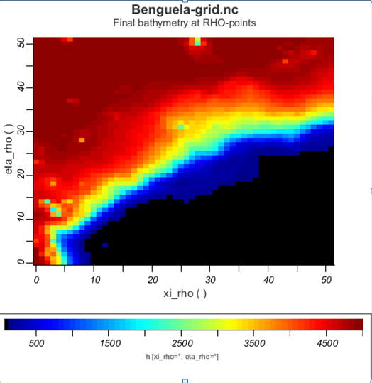

But I find the bathymetry and mask turn right for 90 degree. It seems seagrid2roms does not work correctly. I also wonder whether the script " c_grid .m" will prepare the grid and whether it can interpolate the bathymetry on the grid.

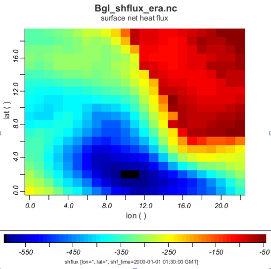

I followed the "d_ecmwf2roms.m" to prepare the forcing files. But I found the variables like 'sustr', 'svstr', 'shflux' , 'shflux' etc. were not interpolated on the grid. That is to say, the grid of forcing files and grid file do not match. Should I add an interpolate procedure after this? How?

1. I am not sure what causes your problem, but I notice that you use both ncwrite and nc_write. Is it a typo? The Matlab native function "ncwrite" and the other function "nc_write" of snctools use different ordering of array indexes, which results in 90 degree turning. This may not resolve your problem, but this is what appears in my mind when seeing 90 degree.
2. No, interpolation forcing files to ROMS grid is not necessary. ROMS will do it internally.

I found another main reason of the right turning of grid is I did not notice that the first point of boundary.dat file read by seagrid must be in up-left corner. I have changed the rearrangement from
8.0 -38.0 1
22.0 -38.0 1
22.0 -26.0 1
8.0 -26.0 1
to
8.0 -26.0 1
8.0 -38.0 1
22.0 -38.0 1
22.0 -26.0 1
I also replaced ncwrite to nc_write. Now, everything for grid goes right.

ROMS will only interpolate forcing files of a certain format. You have to interpolate your own initial and climatology files. The DAMEE example predates the internal interpolations.
