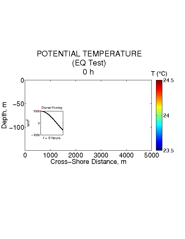

Hi again,
I've included an image of the surface temperature and the mid-depth salinity from the restart file of another similar run. Nearshore (the left side) is full of NaNs.
I've also included a transect of the temperature field through time. Just before the blow up, the nearshore region cools at a noticeably greater rate.
I'm not entirely sure why this blow up occurs, nor why the simulation works if I use the BVF mixing scheme instead of the current GLS (gen) scheme.
The run log is also attached below, as well as the .in file and the CPP defs.
Thanks again for your help!
Best,
-aryan
Best,
-aryan

You've got a dense bottom current flowing downslope from the left to the right. Dale Haidvogel has studied a similar problem and many models have various troubles with such a thing. You might find that some GLS options are more stable than others.
I see you have zero depth at the coast. Try deepening that just a bit.

Re: Blow up with LMD_MIXING and GLS_MIXING but BVF_MIXING wo
A note for novices: without wetting and drying enabled, ROMS will blow up if zeta drops below -h at any grid point.kate wrote:I see you have zero depth at the coast. Try deepening that just a bit.
Thank you both for your quick replies.
"#define WET_DRY" ---> wow, silly me, I could have sworn I already activated this. Thank you so much for pointing that out!
I'm investigating GLS parameters that will hopefully bring the model to stability; I'll post when I find a set that works.
With regards to the minimum depth, this grid is set to a minimum depth of 4 m, which may not be deep enough, and in the creation of the .nc grid file, masking was indeed turned on such that rho points shallower than the min depth were masked with 0.
I do have some confusion regarding this however:
When I create a grid (as an .nc file), I can set a minimum depth, and I can activate masking. Concurrently, in the ocean.in file, there is a DCRIT parameter (right now I'm setting it to 4 m) for wetting/drying. As some cells will already be masked with 0 (and will always be dry, with a depth = DCRIT), it seems I need to increase DCRIT to a value even greater than 4 m? However, as I haven't defined WET_DRY yet, this seems like a moot point.
I'll report back. Thank you both again!
Best,
-aryan
