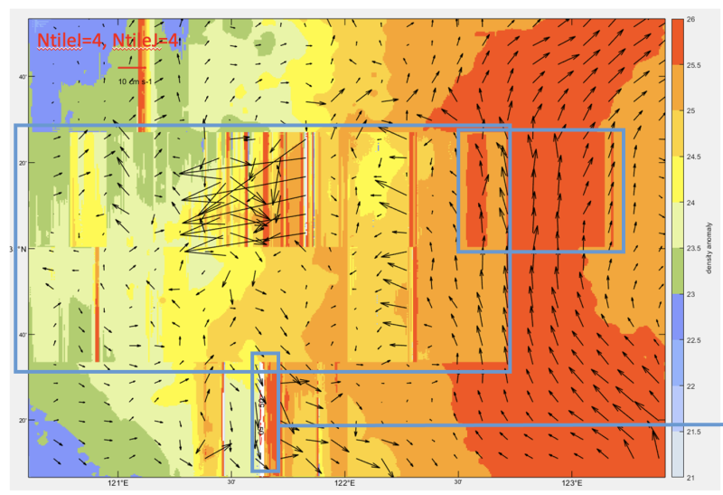

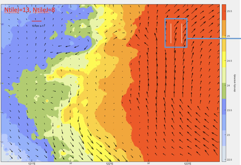

I'm trying 2-way nesting in an existing run. I made the refined grid and contacts files using the matlab tools. Then I recompiled the executable using the NESTING flag. When I try to run it with mpirun I get a segmentation fault right away. I'm running on 144 cores across 6 nodes. One question is about the tiling specified in the .in file: should I set the tiling so that both the coarse and fine grids use all the cores? Also, when calling mpirun do I tell it the nodes to run in the usual way (a list) or do I call the nodes out separately for each grid?
I will also try some experiments with dogbone. Thanks for your help.
Yes, this is required. The product NtileI times NtileJ must be the same in every nest.

When I create a new grid using coarse2fine.m what is the correct number of rows and columns to put in the .in file for the refined grid? For a regular grid I just look at the size of a field on the rho-grid and subtract 2 from both dimensions to get the right number. Is it the same for the refinement grid or do I have to subtract more because there is a larger boundary region associated with the contact area? I ask because I keep getting segmentation faults when I try to run with 2-way nesting.

the child grid should be listed with the -2 in each direction as well.
try to compile in debug=on and run oceanG to see if you get more info.

Thanks to everyone for your help. I did succeed in getting my realistic run to work with 2-way nesting. The problem is that the performance is poor. I'm running on 144 cores using the Intel compiler and mpi. The parent grid alone runs at faster than 1 minute per hour, and the child grid alone in 3 minutes per hour. But when combined using 2-way nesting they slow down to 26 minutes per hour, about 6x slower than I would expect.

I have a nesting error, and I am not sure if it is somthing to this topic.
I have two exp, they are both online-nesting. One is two-layers, outer parent grid's rho points is '221*303' (grdA), and its child grid (refined factor = 3) is '362*254' (grdB). I test one year, it can run. And I set NtileI=13,NtileJ=8 for both grids.
Another is three-layers, it add a refined grid of grdB (refined factor=3), and its rho points is '505*392'. But, three-layers case go wrong. I tried both 'NtileI=13,NtileJ=8', or both 'NtileI=4, NtileJ=4', blowing-up in different steps. What's more, their rst show different. I plot their density anomaly of inner grid at blowing-up time.
NtileI=13, NtileJ=8: blow up after only 3 steps
NtileI=4,  NtileJ=4: blow up after 18 hours modelling
I am stuck in this issue for a long time, and try to modify topo, it seems not work. I don't know how to solve this problem. Could anyone help?
Many thanks in advance. :D

#19 Unread post by Dan_chan »
Hello everyone, I apologize for resurrecting this post. However, I believe I have identified where my previous issue occurred. It relates to the advection schemes, and I realized that the new version of ROMS allows for setting advection schemes for each tracer with switches instead of a single CPP flag for all of them. I omitted the advenction schemes of inner grid in my roms.in. It is really very very careless. The absence of advection schemes for the inner grid accounted for this issue. Now, it can run when I supply the advection schemes for the inner grid. Although I am still unsure why it experienced blowups at different steps previously, it is possible like that the instability resulted from differences in server stability.
