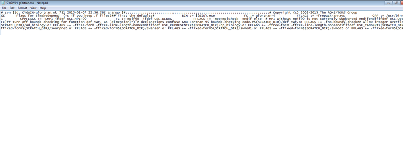

Line 29 is this: FFLAGS := -frepack-arrays
exactly similar to what you wrote. However, the whole file is in only 6 lines in notepad and they are all consecutively written without any new line in between different commands. Following is a picture of it:
Re: make_macros.mk WHICH CONTAINS APPLICATION-DEPENDENT MAKE
#10 Unread post by kate »
There are multiple posts in the archives about downloading ROMS on the Windows side, then trying to compile in CYGWIN and running into trouble. Is that what you did? You need to be consistently in CYGWIN while downloading and compiling and all.

#11 Unread post by hadibh »
I think I did everything in Cygwin. However, I am going to repeat installation process and if I failed again I'll consider linux. Thanks for your suggestion.
