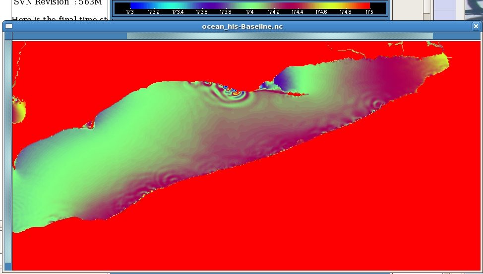

Here is a snapshot of the free-surface zeta at the blowup time:
Figure 1.
Figure 1.

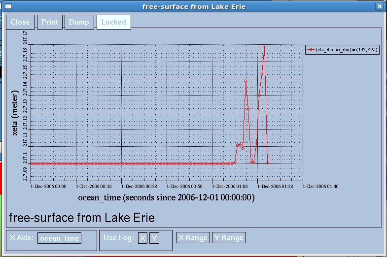

Here is the lake level in a couple of cells along the northern shore near the cliffs:
Figure 2.
Figure 2.

Back to the original problem: The shoreline instabilities are still present. The free-surface zeta looks similar to Figure 1, although the oscillations are slightly bigger. The blowup occurs at 01:27:18 hours in cell (495,147). Here is the plot of zeta for that cell (along the southern shore):
Figure 4.
Figure 4.
Figure 4. Instability in zeta along the coast.
The jump in the water level in this plot is small, only 0.07 meters (from 217.1 to 217.17 meters). But this cell is 43 meters above the lake surface (at 174 m asl). Why is it getting wet? Surely the water is not really splashing up that high.
