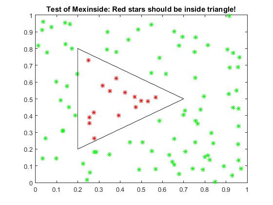

I´m trying to install the seagrid mex files in matlab and i do as follows:
>> make_seagrid_mex
Building with 'Microsoft Windows SDK 7.1 (C)'.
MEX completed successfully.
wait for the figure to finish plotting, then hit any key to continue
and a figure is shown (attached file *.jpg), then hit any key to continue
and i get this:
