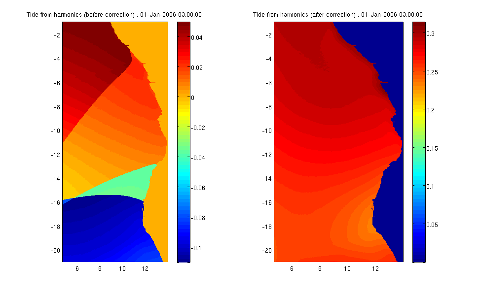

The following figure, computed using the matlab script above, shows the tidal contribution to zeta in meters before (left) and after (right) the factor has been applied. Note the field has become smooth in the corrected version instead of disjointed as was the case for all different times I calculated.
I've also tried looking at other grids and other tidal forcing but the changes from 'corrected' to the current code dramatically vary from different locations :shock: Some were more simply just different and didn't experience this disjointed to smooth transition which makes me second guess my logic :? I am still quite the amateur at ocean modeling so if I have made a mistake that's quite obvious I won't feel at all bad to be corrected! Thanks! :)

Ok I've made a vital mistake! :( I didn't think to double check the units in varinfo.dat instead I just looked at the information given in mod_tides.F....
'tide_Ephase'                                      ! Input
  'tidal elevation phase angle'
  'degrees'                                        ! [radians]
  'SSH_Tphase, scalar, series'
  'tide_period'
  'idTzph'
  'r2dvar'
  0.017453292519943295                             ! pi/180
So when reverting to the original ROMS code and simply multiplying my SSH_Ehpase by (pi/180) such as in varinfo.dat, instead of (1/360) as I was doing, my output returns to a smooth field!
However this only makes the choice between the two even harder as the 2*pi/Tperiod(itide) correction is also a smooth field just a different shape.... :? The 24hr variability in the original code version does seem more correct than my proposed change but I still cannot wrap my head around the difference between formula and the code =(
