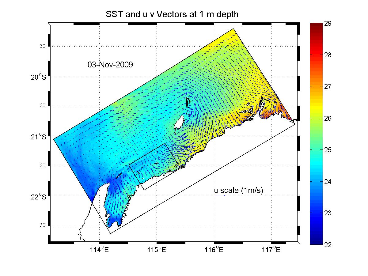

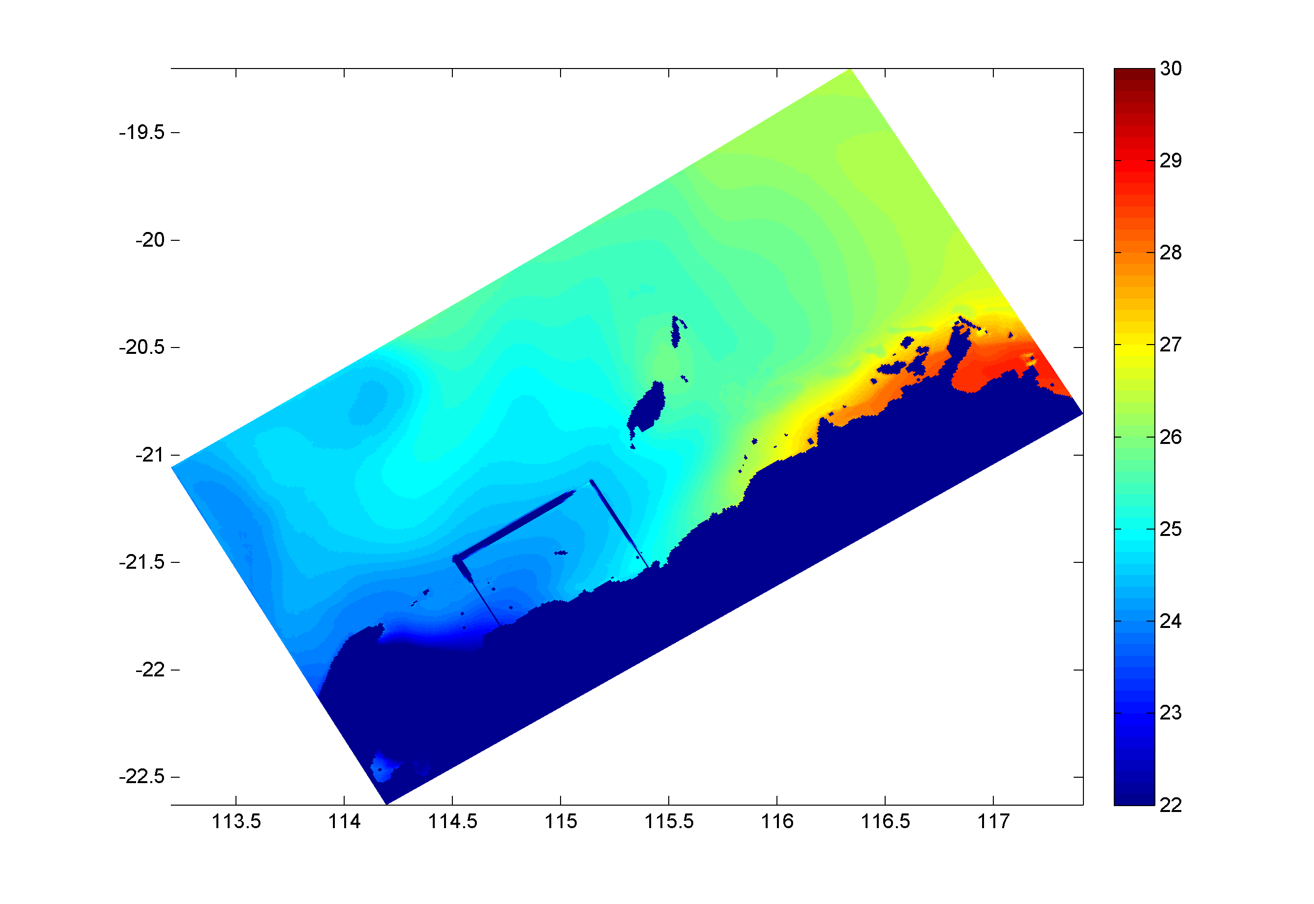

I have no problem to use the previous ROMS version(nesting, no wet_dry), while after I updated the code yesterday,I could not run the model any more. It blows up after ~50 time step. see the attachment (SST of restart file): the SST changes a lot on the coarse fine boundary. I guess there is a bug in the fine2coarse code or in the contact.m script. Is there anyone seeing the similar problems. I reckon this update is a big overhaul, so I am not surprise to see some bugs.

This is my previous model output. It looks all fine. Note that I have also updated the matlab repository, created an new contact input file.

I have checked the new released codes carefully for the last two months (countless hours in the debugger) with idealized and a realistic applications in the South China Sea and the US East Coast and they work fine. The one that you were using before have several serious bugs. I don't know what is wrong with your application. You need to spend time investigating if your nested application is correctly configured. I cannot do that for you.
I suspect that your problem is in how the refined grid was generated. We are improving Matlab scripts like coarse2fine.m to absolutely guarantee that the area of the coarse grid is conserved. The computation of pm=1/dx and pn=1/dy metrics need to be correct. We need to have:
for every contact point in the contact regions inside a coarse grid cell. Perhaps, you can check if this is the case in your application and learn something about it in the process. You need to start checking your set up more carefully. If you are not conserving area and steady state volume, you will be in trouble and will need to re-generate your grid NetCDF file for the refined grid.
dx(coarse) = SUM[dx(fine), 1:RefineScale]
dy(coarse) = SUM[dy(fine), 1:RefineScale]
area(coarse) = SUM[area(fine), 1:RefineScale^2]
I don't know when I will finish reworking few Matlab scripts. I am taking vacations.

Oh, I did not notice I need to regenerate the refined grid. That could be the problems. I actually modified the refined the batyhymetry to improve the depth, and matched them at the coarse fine boundary. I will need to recreate this grid and see how it goes. Many thanks.
