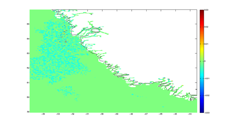

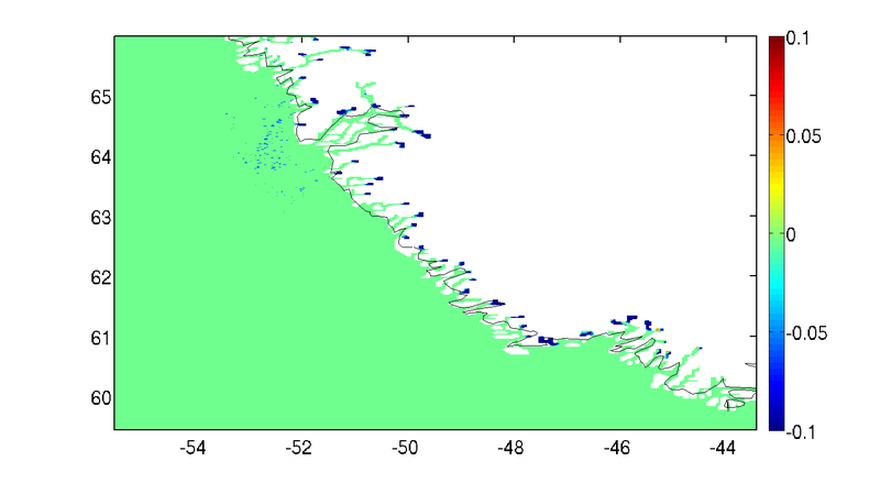

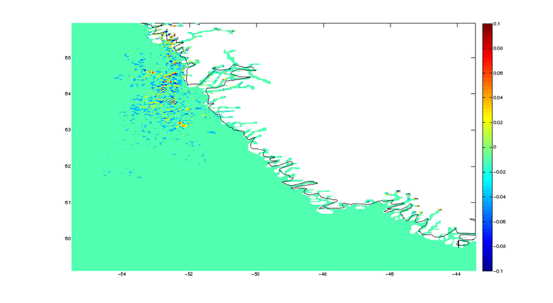

I have set up a run without-river and got some results. Then I turned on the flag "TS_PSOURCE" in cppdefs.h to apply river forcing as point sources. After generating the river forcing files, I gave all the river discharge rate zeros and keep the S/T constant values as initial condition state. Then I would like to run this "river input" ready model with "ZERO" river input discharge to see whether I would like to get the same answer as without-river one. Here are my results after 132000s run (my timestep is 100s).
Clearly, there are something (noise or so)? I have also tried to give a very small discharge rate, say 2m^3/s, the results are almost identical. But if I changed the Salinity with time in the river forcing file (with river_flag as 2) to simulate freshwater input, even still with ZERO discharge rate, I can still clearly see the big difference at all the river input locations. Not sure what is wrong. Can anyone explain to me what I should do to correct this?
Any suggestions are highly appreciated.

Temperature difference 132000s after model run between with-river but zero discharge and without-river run. (with S changes in river forcing)
Salinity difference 132000s after model run between with-river but zero discharge and without-river run. (with S changes in river forcing)
Temperature difference 132000s after model run between with-river but zero discharge and without-river run. (with constant S in river forcing)
Salinity difference 132000s after model run between with-river but zero discharge and without-river run. (with constant S in river forcing)

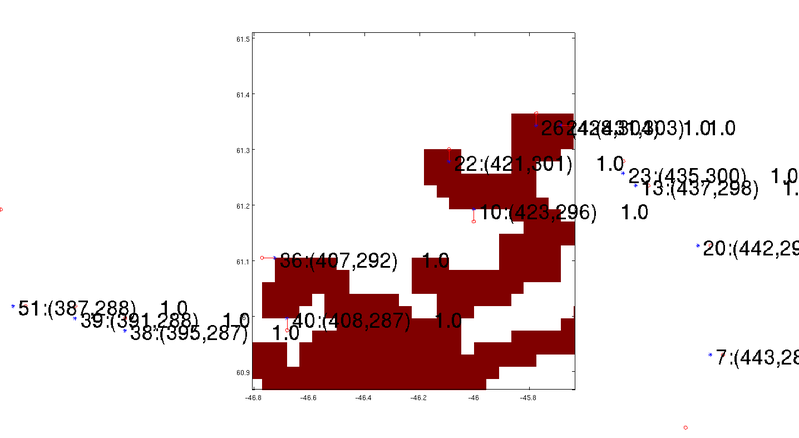

I have downloaded the map_river.m, and changed the river locations against the wall (u/v mask point). Here is the figure generated with map_river.m, I am not sure it is right?
For the river flow east: river 36
For the river flow north: river 40 and river 10
For the river flow south: river 22
For the river flow west: river 24
I am thinking something weird here, especially when river discharge rate is negative to show the direction. Which ones are right? (10, 40, 36) or (22 and 24)
Please let me know then I will make corrections for the river locations.

That matlab script didn't work on my rivers file for some reason, so I have to guess what it's doing. Are you getting no influence from 36 and 40, influence from 22 and 24? It looks like 36 and 40 are in the land mask, not on the land-sea boundary.
For flow into cell i,j, you need to set:
From west, cell i,j, dir=0
From south, cell i,j, dir=1
From east, cell i+1,j, dir=0
From north, cell i,j+1, dir=1

Kate is right. It seems you have 36, 40, and also 10 in the land mask. In this code, river is pointing from circle to star, and for a right location, its circle should be on the land-sea boundary and star in the water point, as points 22 and 26 do.

Thank you again for the advise. It is weird for me that for the locations shown in the map, all 36, 40, 10 and 22 and 26 location rivers disappeared on my test case. The figure I posted is plotted with map_rivers.m, I have checked to move the river input points around, and I found out that:
If the river goes east like 36, I have to put river at point (408,292)
If the river goes north like 40, I have to put river at point (408, 288)
If the river goes west like 24, I have to put river at point (429,303) moving left one
If the river goes south like 22, I have to put river at point (421, 300)
I have followed the suggestion of kate, 36, 40 and 10 are working as shown above. But all negative rate (west, south) rivers all disappeared if I applied the location in the map I posted.

The rivers are defined on the u-points and v-points of the grid into a rho point at i,j. See the diagrams here.
Note that other models use a different numbering scheme where rho point i,j is surrounded by u at i-1,j and i,j. Viewing fields in ncview might make you think that's how ROMS numbers things, but you'd be wrong.
