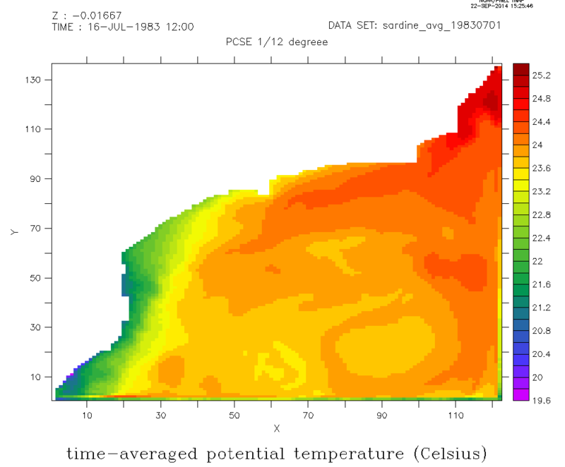

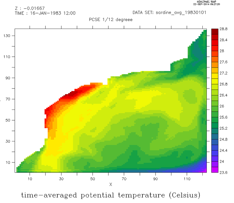

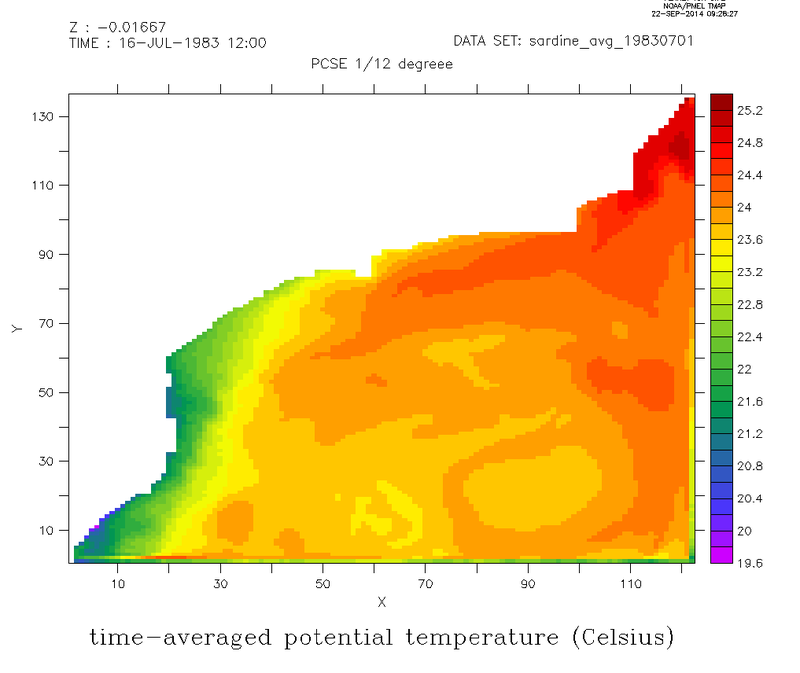

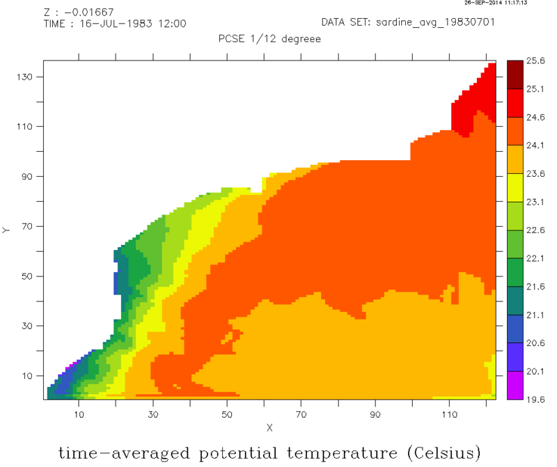

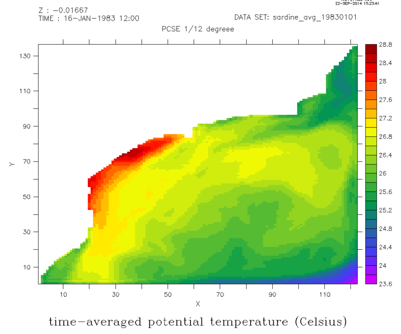

I am running ROMS 3.8 for Southwestern Atlantic, and I am having trouble with my boundaries. I have tried different settings, but I always get an odd gradient at the borders, as you can see in the figures attached.

I've tested the boundary conditions Shc and Che, as you suggested, but did not solve my problem.
I am running my simulations without the tides. And I have done several simulations with different NUDING values, but it did not solve my problem with the edges.
I have also tested other boundary conditions with different scales for NUDING, but the edges always continue with the same problem.
I decided to test your suggestion in version 3.7 and the edges improved when compared to the same simulation with version 3.8(attached).
What has changed from one version to another that may be interfering with these rims?
I also have another problem. In this area there are two upwelling centers that can not be observed in my simulations, in any of the ROMS versions. Maybe it could have to do with the parametrizations which affect the interaction with atmosphere?
