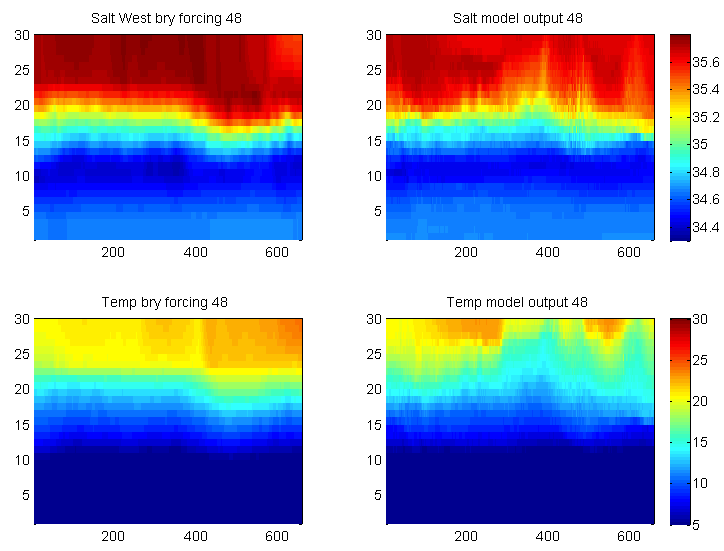

I am still fairly new to ROMS and I have been struggling with my model of the Western Australian SW coast for quite some time now. Currents do not seem to radiate through the boundaries properly, I get unrealistic current velocities in deep areas along the boundaries, and eddies get trapped in the domain.
Current velocities at 500m
Surface temperatures
When comparing the salinity and temperatures in the western boundary (and the other boundaries) to the model output there is a pretty big drift after only 1 1/2 months, this drift gets larger with time.
Comparison between salinity and temperature boundary forcing and model output at the western boundary

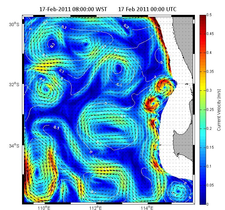

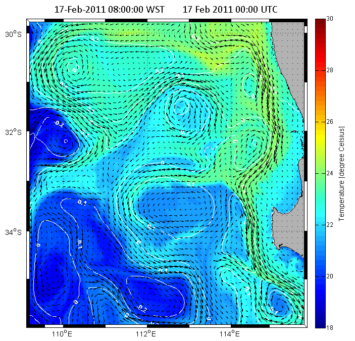

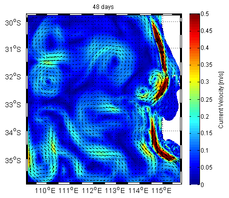

The barotropic current also seems to be running along the boundary and eddies get trapped.
UVbar

Re: ROMS boundary radiation problem
Interesting point, I don't nudge to a climatology but to UV, UVbar, Temp, Sal, zeta from the boundaries and surface forcing. Does this mean I do not need to need #define TClimatology and #define TCLM_NUDGING?
If you only want the boundary condition nudging and the SSS nudging, you do not need TCLM_NUDGING. TCLM_NUDGING is for nudging to a 3-D field with possibly spatially varying coefficients. I'm surprised it let you have TCLM_NUDGING without TCLIMATOLOGY, but whatever, I'm not checking out an old ROMS 3.6 to see what it has in checkdefs.F.
Posts: 936
#5 Unread post by wilkin »
A couple of things I notice are that your initial conditions for ubar and vbar are zero, whereas your initial 3-D velocity is not. In principle, the adjustment to this unbalanced state should be swift but it's something to be aware of.
Secondly, if you have not modified the Functional that sets analytical nudging time scales, or provided those in the separate nudging file, then the nudging at the boundary defaults to your Tnudg values of 360 days which is very weak. To impose this exterior ocean information at the boundary you want a much shorter time scale. Also read about input parameter OBCFAC which controls how that nudging timescale is modified depending on whether the radiation condition detects outflow versus inflow.
Third, it does not appear you have set these:
** ADD_FSOBC use to add tidal elevation to processed OBC data **
** ADD_M2OBC use to add tidal currents to processed OBC data **
so I suspect your tides may not be added.
Tides can have a dramatic and positive effect because they virtually guarantee that the radiation conditions sweep external water into the domain half the time, even if the radiation conditions want to do something stupid. So this helps impose the far field ocean conditions.

Thank you Kate and John,
Okay, I turned off TCLM_NUDGING.
Good point, however, do you think that would effect the model after it runs for a month or two? Easy to fix anyway.
This is something I am having trouble with. How do I determine the ideal nudging parameters? Is it simply trial and error? I have seen everything from Tnudg = 1 with OBCFAC = 10 to Tnudg = 360 with OBCFAC = 120. Would Tnudg = 1 and OBCFAC = 10 be too strong? What are typical signs that show that my nudging is too strong? I assume signs that it is too weak would include a large drift from the boundary conditions after a short time?
I added ADD_FSOBC and ADD_M2OBC to my model now. From what I can see (so far) there is a big change to before, I can't tell yet if the model is actually improved.
