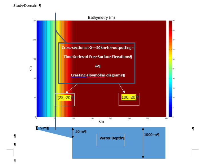

Here I attached my ideal study domain. The point(1,1,8) is located at boundary of the shallow water. But I was wondering if grid cell (1,1) is ghost cell or not? Basically when I create the domain, I didn't mask any cells dry because it is a simple test for an assumption in our real case study.
I set number of vertical layers to be 8. Here are my basic grid dimension parameters:
Lm == 174 ! Number of I-direction INTERIOR RHO-points
Mm == 124 ! Number of J-direction INTERIOR RHO-points
N == 8 ! Number of vertical levels,feng-try-2D first

Nothing beats actually looking at the source code for some of these questions:
For rho point (1,1), it is getting input from both interior and boundary points. Because the west is closed and the south is periodic, I wouldn't expect trouble to come from the boundary points. You haven't driven 5 m of water away in 4 timesteps, have you? What is zeta there?
Depending on your vertical mixing, you might be resolving the surface boundary layer in your shallowest water, but probably not in the deep water. Your jump from 50 m to 1000 m depth is scary and will lead to spurious currents along that wall.
The BODYFORCE option applies the forcing over some uniform number of k levels, surface forcing from k=N down to k=levsfrc, bottom forcing from k=1 up to levbfrc. Both LEVSFRC and LEVBFRC are set in the ocean.in.

I have tried with BODYFORCE, but there is no much improvement. The model still blows up either at western boundary or at the junction between shallow and deep water, due to the speed trouble. Now I am testing svstr = 0.5N/m^2. And the current velocity along y_rho direction often gets into a very large value( > 40 m/s) either at bottom or at surface.
I could eliminate the surface stress near western boundary, but that will be against my initial goal. Since I would like to see how the free surface elevation in the shallow water behaves driven by the wind with a scale of hurricane-status. Also, for the steep slope, if I smooth it, it will be bias from the reality which I am simplifying.
So I was wondering if the above issue is due to sigma grid. If so, can 2D simulation avoid the above issue? Also, can ROMS do hybrid grid or z gird? If so, how shall I implement it?
I also appreciated any ideals to improve my simulation.
Thanks.
Thanks.
Re: Analytical Tide defined in O.B.C. in COAWSTv3.1
If you do a 2D simulation, you will avoid the pressure gradient errors associated with the jump in bathymetry. I'm not sure you get rid of all the errors associated with it, though. I know the real world has some pretty steep bathymetry - that drives some of our desire for increased horizontal resolution. You can replace the jump with say a tanh function and increase the resolution there - but you want to change resolution smoothly too. I know that's not the problem you want to be solving, but it's the problem the model was designed to handle.
The BODYFORCE option was designed for domains which are deep everywhere and with insufficient vertical resolution. Our more recent runs have just gone for more vertical resolution (N=50) and I haven't used BODYFORCE in over a decade.
I'm not a hurricane expert, but is that really the surface stress from them? That's a very large surface sress. I've heard that in nature, increasing the winds doesn't lead to ever increasing surface stress and that the default ROMS bulk flux routine overestimates stress at high winds.
OK, checking my Bering Sea storm case, the wind stresses get up to 1 N/m^2. It is running fine. I've got hmin=5, N=50, tides, WET_DRY, and enough bathymetry smoothing to bring the rx0 down to 0.3 (search on Beckmann in the ROMS stdout).

I masked some cells that blowing up to be dry and now it works fine. I am also trying to make a new grid just as you said making a transition from the shallow to deep. But what I have found that is the cell during this transition portion is very weird, they will have 2km in eta_rho but 180m in x_rho direction in order to have a smooth slope of each cell grid (delta_depth = 0.9m). I am not sure that if this is a good idea. Also, I was wondering since I make the cells in the transition portion to be finer, do I need to apply the same fine resolution for my shallow water area?
Thanks.
Thanks.
That rx0 is a measure of how much your depth changes from one grid to the next. One could also create a metric for how much your dx changes from one grid to the next, plus a metric for grid aspect ratio. I don't know of any careful studies of either of those.you want to change resolution smoothly too.
