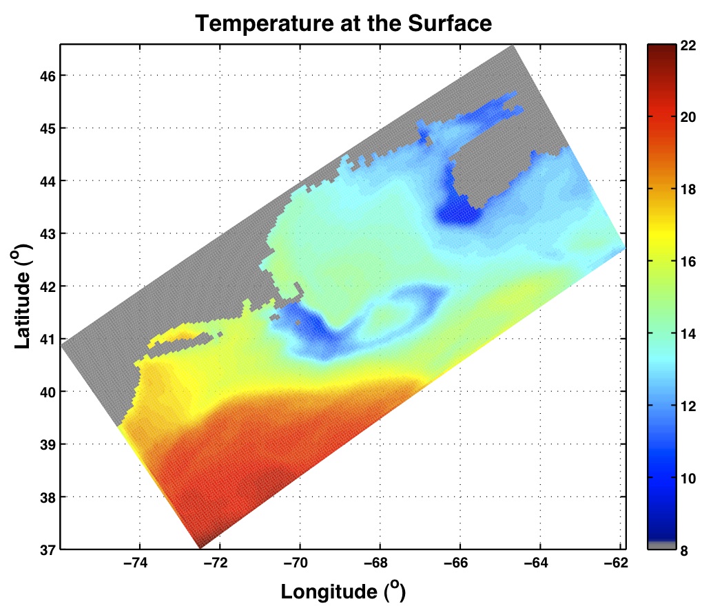

Dear Users,
We have made several tests about the nudging problem according to the suggestion.
When climatology nudging is defined, we set the nudging coefficients from 5 days to 60 days 8 grids away from the boundary(changed from DAAMEE_4 application
cff1=1.0_r8/(5.0_r8*86400.0_r8)
cff2=1.0_r8/(60.0_r8*86400.0_r8)
DO j=JstrR,MIN(8,JendR)
DO i=IstrR,IendR
wrk(i,j)=cff2+REAL(8-j,r8)*(cff1-cff2)/8.0_r8
# ifdef ZCLM_NUDGING
DO j=JstrR,JendR
DO i=IstrR,IendR
CLIMA(ng)%Znudgcof(i,j)=wrk(i,j)
). Since there is warning not changing the code about the boundary coefficient, we didn't change it. In my understanding about the code below, the boundary nudging coefficient is set to the value of climatology nudging coefficient at the corresponding location (so 5 days at the southern boundary), and then the climatology nudg coef at the southern boundary is set to zero; however, in the comment part of ana_nudgcoef,h, it is said that: 'Notice that interior nudging coefficient defined above are zero out when boundary condition nudging'. How does it zero out the interior climatology nudg coefficient? I cannot see from the code.

The main problem we came into with this application is that: At the western boundary, there is a very sharp gradient in temperature. A strip of lower temperature appears. Would anyone please give us some suggestions? Thank you very much. Following is the cppdef about the nudging.
