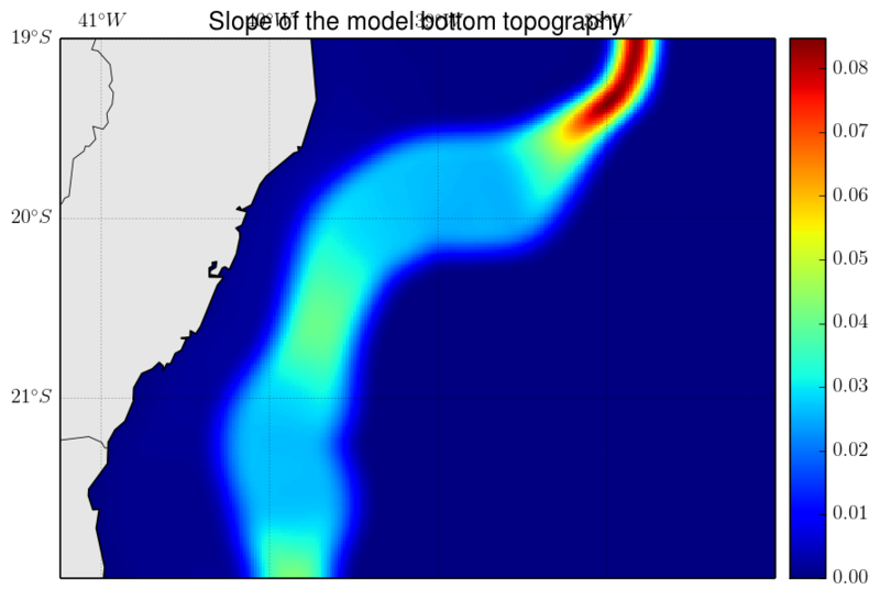

I'm having problems with pressure gradient errors over an idealized continental slope application. My initial field is just flat stratification, with an N2 profile derived from a climatological dataset. I have baroclinic (barotropic) velocity errors of 10 cm/s (4 cm/s) after a steady-state is reached, when a clear along-slope jet develops (attached).
The horizontal resolution is ~1.65 km in both xi and eta directions. The number of vertical levels is 50, and the coarsest vertical resolution is 80 m, near the bottom (attached). Vtransform = 2, Vstretching = 4, Tcline = theta_s = theta_b = 0. Sponge layers that ramp the harmonic viscosity and diffusivity coefficients up to 5 times their inner values are set along all 3 open boundaries.
Boundary conditions are: Chapman explicit for the free-surface, Shchepetkin for the normal 2D velocities, Gradient for the TKE field and Radiation + Nudging for the tangential 2D velocities, 3D velocities and tracers. All nudging is done towards the initial conditions at the boundaries, that is, flat T and S profiles, and zero everywhere for all velocities and the free-surface, reflecting the initial state of rest.
The Beckmann and Haidvogel number (rx0) is 0.075, and the Haney number (rx1) is 3.7, which I understand are conservative values. The current values for the harmonic viscosity and diffusivity coefficients is 200 m2/s. I experimented with 50 m2/s, and the error is only about 1 cm/s larger. With a biharmonic viscosity of 4.5e+07, the error is about the same. With biharmonic viscosity and biharmonic diffusivity though, the error oscillates violently between 10 cm/s and 100 cm/s.

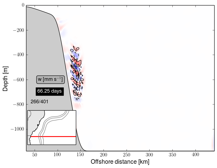

The things I have already tried so far are: Playing with the vertical stretching curve, increasing the vertical resolution, increasing the horizontal resolution, changing the mixing coefficients between harmonic and biharmonic (and their values), decreasing the actual slope of the continental slope (currently the maximum slope is 0.03), capping the topography at 2000 m (it was 4000 m before), using time-dependent horizontal mixing coefficients (UV_SMAGORINSKY and TS_SMAGORINSKY options), changing the rotation of the viscosity/diffusivity tensors between along S-surfaces and along geopotential surfaces (MIX_S_TS, MIX_GEO_TS, MIX_S_UV and MIX_GEO_UV options), changing the boundary conditions, putting the sponge on and changing the pressure gradient algorithm (which showed that the DJ_GRADPS is the algorithm that produces the smallest error for my application. This agrees with the result obtained for the study I mentioned above for the seamount test case, which has similar values of rx0 and rx1). Most of these changes have had small beneficial effects.
I have also checked for errors in the initial field itself, but it is pretty flat, as it should be, only with very small-scale sawed features that always appear in the areas of maximum bottom slope due to interpolation errors (attached).
Any suggestions on ways to decrease the errors on the 3D velocity field to an acceptable level (I think, lower than perhaps 1.0 cm/s) is greatly appreciated.

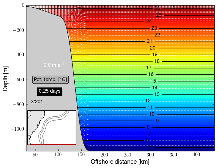

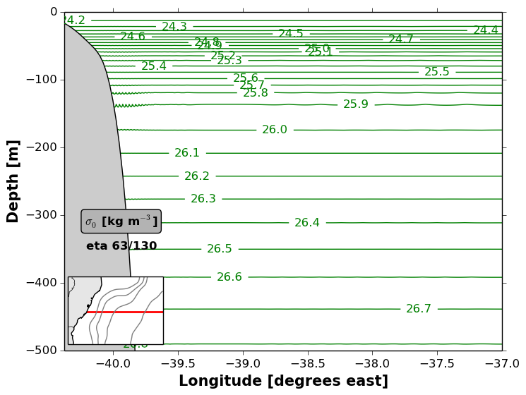

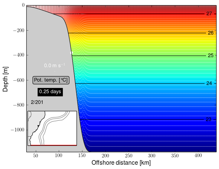

- Initial density field at an eta-slice in the middle of the domain.
- initial_flat.png (78.96 KiB) Viewed 34720 times

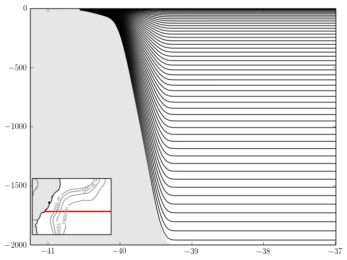

- Vertical grid at an eta-slice in the middle of the domain.
- vertical_grid.png (95.22 KiB) Viewed 34720 times

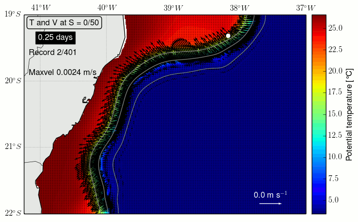

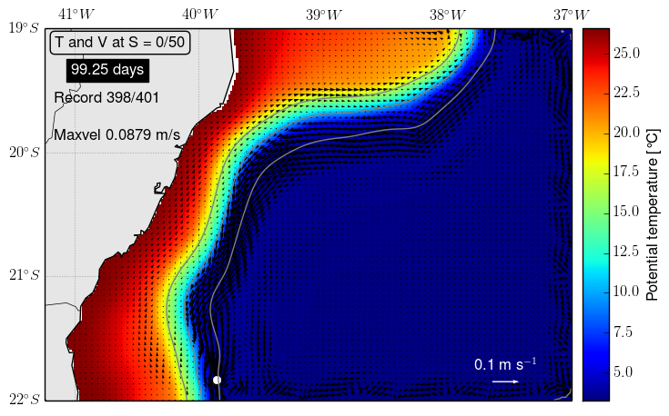

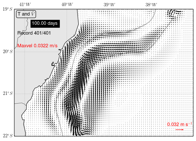

- Vertically-averaged horizontal velocity map for day 100.
- uvbar.png (256.51 KiB) Viewed 34720 times
- Horizontal velocity slice along the s-level where the noise is maximum (near-bottom) for day 100.
- horvel.png (210.02 KiB) Viewed 34720 times

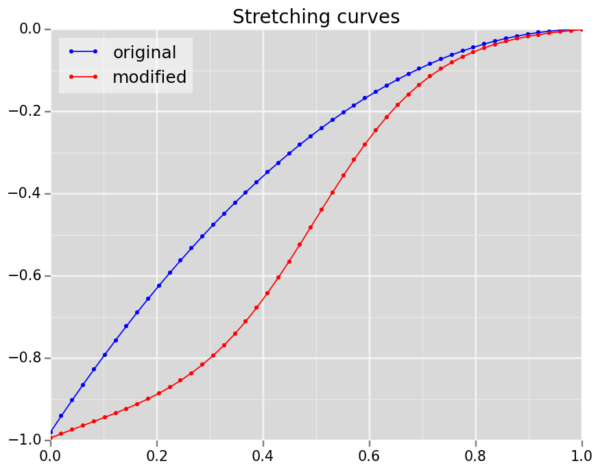

Hi Ianerolle, thank you for your reply.
With the parameters you suggested, the vertical stretching curve becomes the red line in the attached figure. The maximum Haney number rx1 increases from 3.7 to 14.1:
(ORIGINAL) N, theta_b, theta_s, tcline: 50.0, 0.0, 0.0, 0.0
(MODIFIED) N, theta_b, theta_s, tcline: 50.0, 0.9, 4.5, 10.0
Haney number for original case:
Maximum r-value = 3.69139749326
Haney number for modified case:
Maximum r-value = 14.1338503033
Coarsest dz for original case: 79 m
Coarsest dz for modified case: 84 m
However, I have been suggested to prioritize finer vertical resolution (dz, something like 20-30 m) over the hydrostatic consistency of the vertical grid (low rx1). What do you think of this approach? Playing with the stretching curve, I found it difficult to get both low rx1 and fine dz. For example, if I increase N from 50 to 120 with my original configuraton (V_transform=2, V_stretching=4, theta_s = theta_b = Tcline = 0), my coarsest dz goes from 79 m to 33 m, but rx1 increases from 3.7 to 8.9.
I tried lowering rx1 as much as possible in previous tests, by decreasing the number of vertical levels and coarsening the vertical resolution near the bottom, but it did not seem to decrease the errors.
Also, why do you say Vtransform = 1, Vstretching = 1 is a more robust configuration? I mean, do you get less noise with it, relative to the recommended Vtransform = 2, Vstretching = 4 configuration, even though rx1 gets big because of the near-bottom refinement?
Thank you for your time.

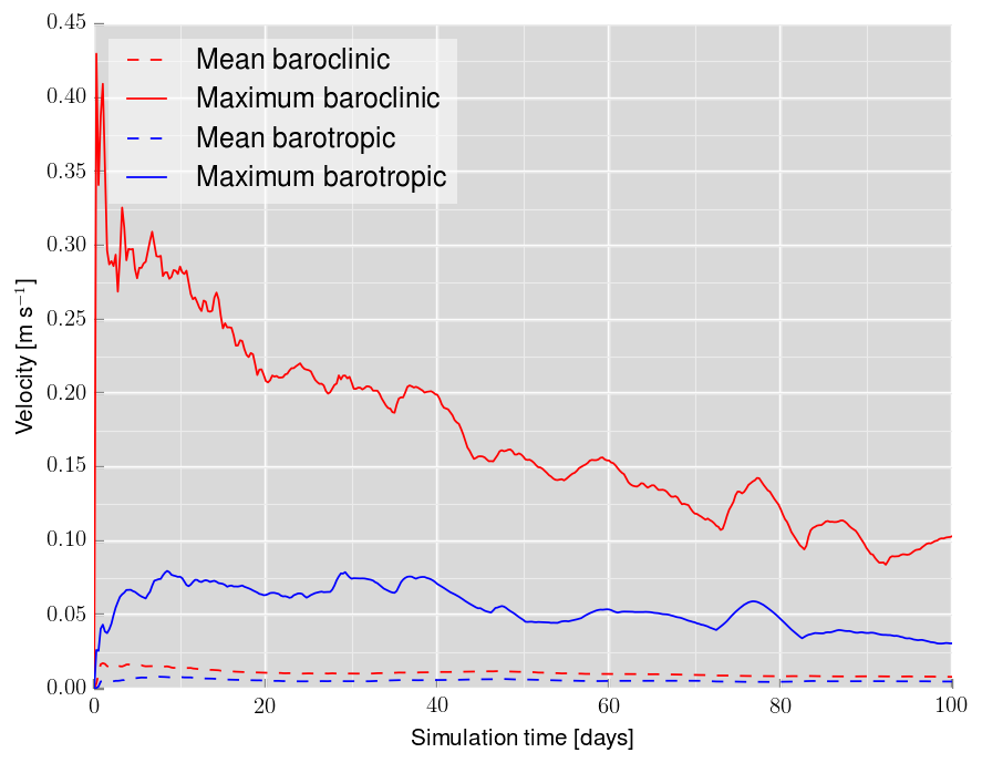

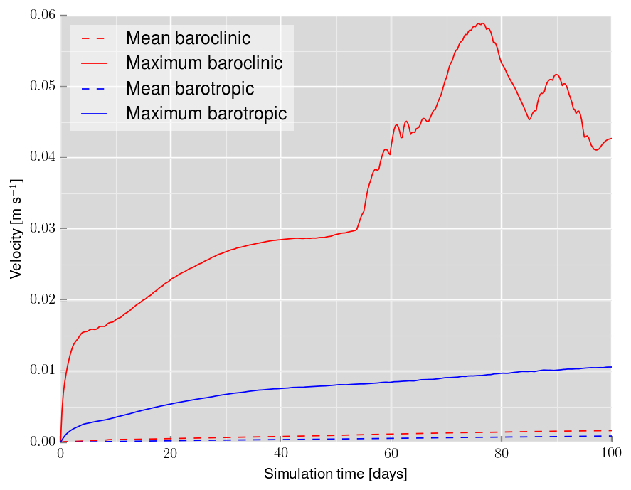

Thanks everyone for your replies.

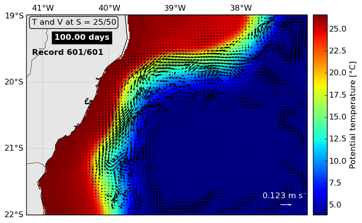

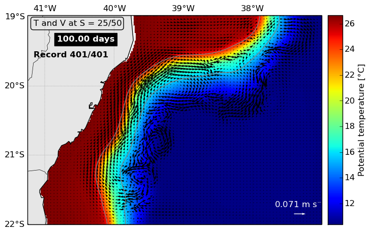

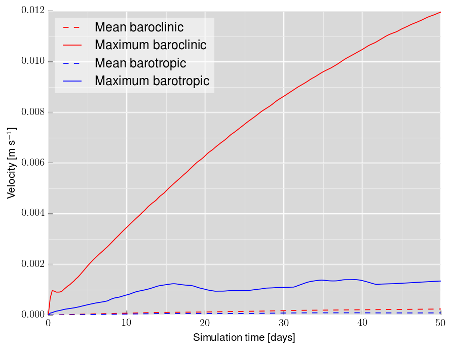

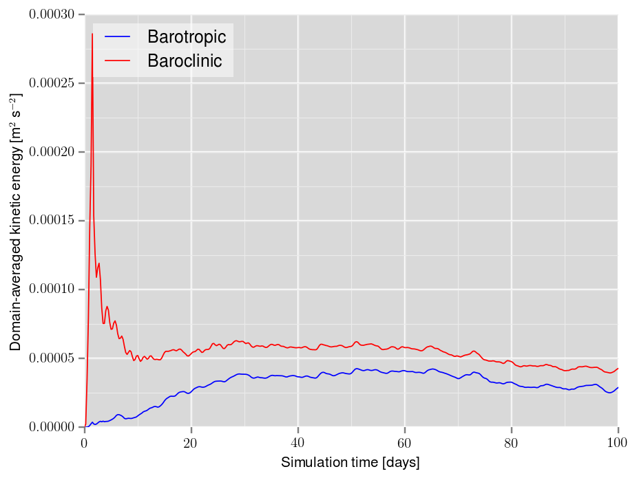

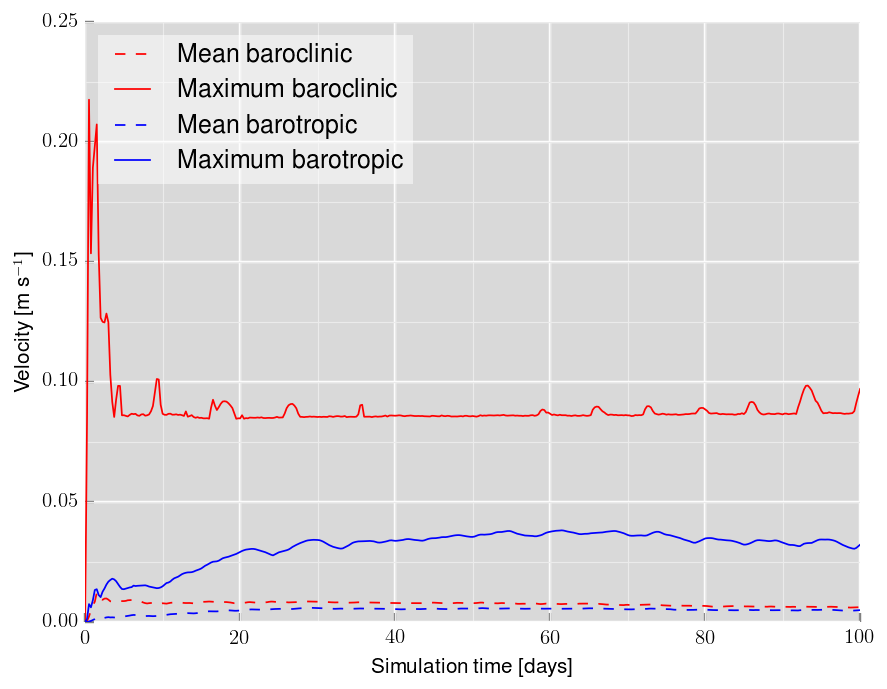

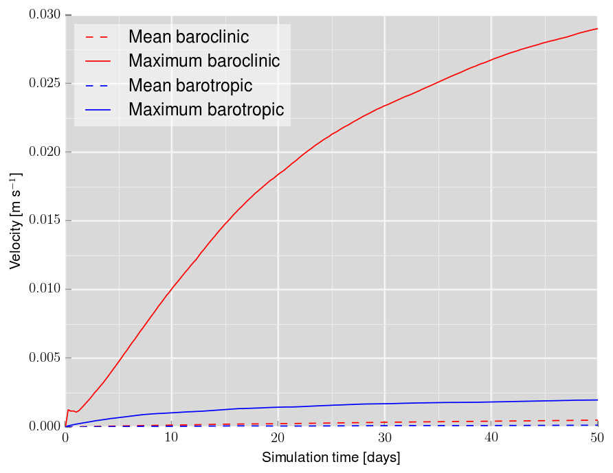

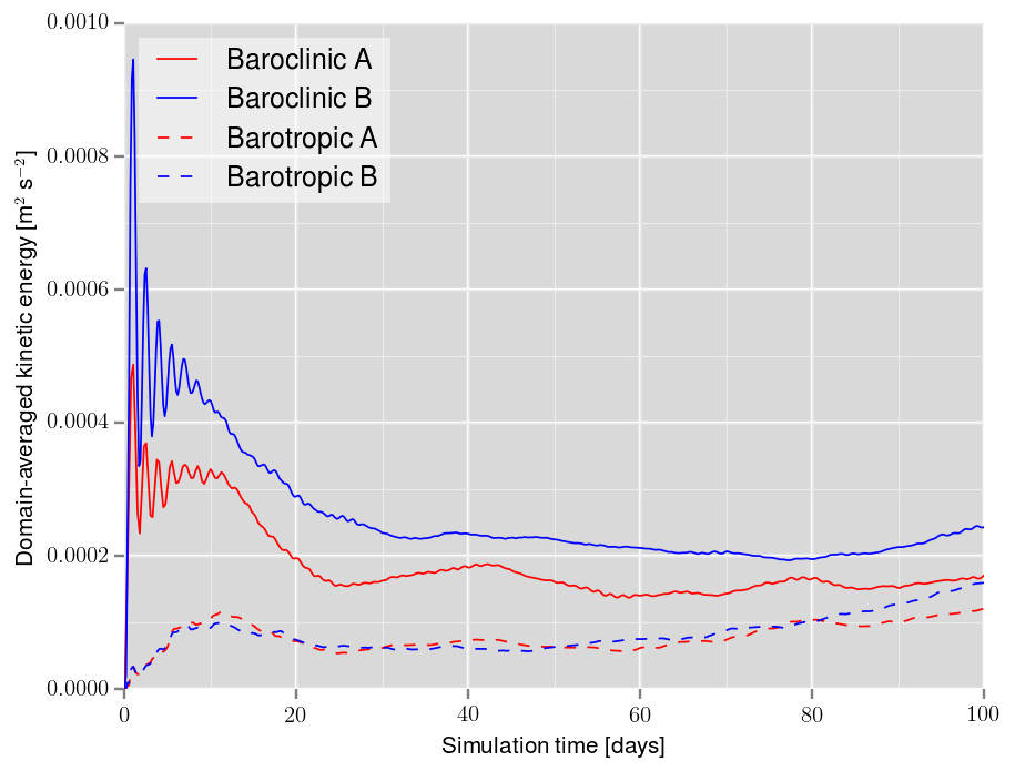

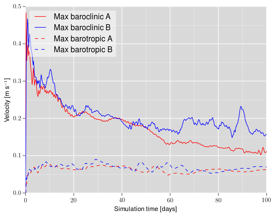

Following Ianerolle's suggestion, I did two test runs changing only the vertical stretching curve as depicted on my previous post. It seems that, for my application, the configuration with Vtransform = 2 and Vstretching = 4 produces less Horizontal Pressure Gradient Error (HPGE). I've attached plots of mid-water velocity and kinetic energy/maximum velocity histories.

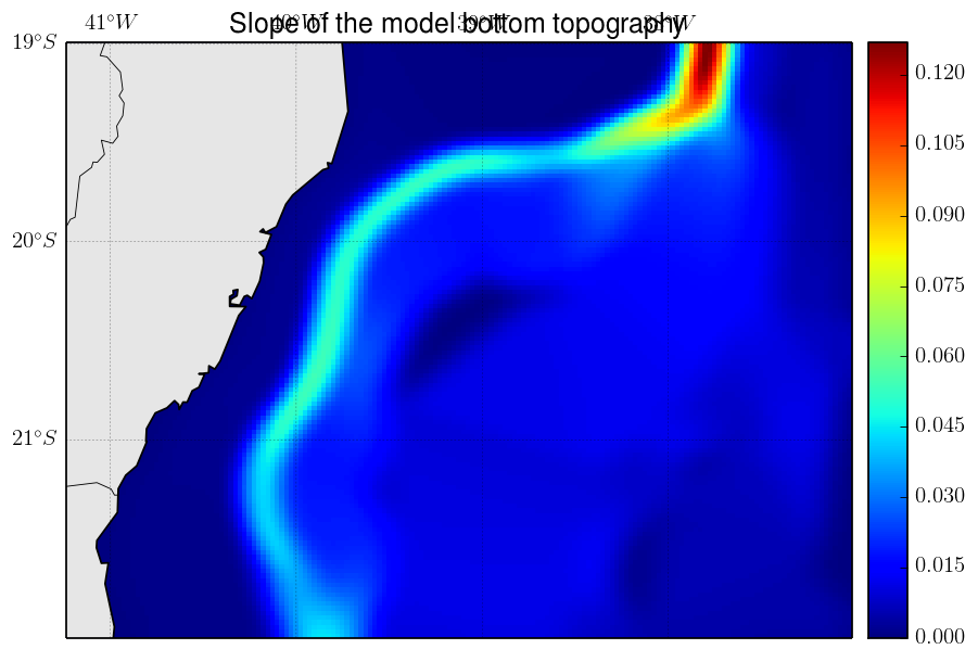

I have experimented with the bottom slope too. the maximum slope was ~0.08, and now is down to ~0.03.
Would it be a reasonable mitigation approach to subtract this flat solution from the solutions with forcing? Evidently, this would not correct any errors due to nonlinear interactions between the flat HPGE flow and the physical flow, I don't know. Has this been tried or looked at?
I see, saulo. That seems to be where the HPGE errors are largest in my application too. But I'm afraid I didn't follow everything you said. You said that you had to increase vertical resolution? But that increases rx1, right? So that's something that has been confusing me: To decrease HPGE, do you need to have low rx0 or fine dz? Or both? Because the way I understand it, if you refine dz, you increase rx1. Was the decrease in HPGE in your case only because you decreased rx1 or you tried other things too?saulo wrote:ct). Like Ivica would say thgough, its all in the grid. In a high resolution application I had to smooth the bathymetry significantly more than I was expecting, I had a reasonable rx1 to start with, something like 7, but had to bring it down to 5 before it started working with "no" PGE. The bad rx1 were on the steep mid slope part near the bottom layers. With the high horizontal resolution I was using, it required even more vertical resolution in those layers than I could afford, otherwise the changes in thickness were still too strong it seems.
- Steady-state mid-water velocity for case B (Vtransform=1, Vstretching=1)
- horvel_day100_midwater_vtrans1_vstretch1.png (241.66 KiB) Viewed 34585 times
- Steady-state mid-water velocity for case A (Vtransform=2, Vstretching=4)
- horvel_day100_midwater_vtrans2_vstretch4.png (235.43 KiB) Viewed 34585 times

Updates:
I capped the topography at 1200 m instead of at 2000 m, keeping everything else the same, and the HPGE decreased from 10-30 cm/s to ~3 cm/s. Also, the sudden acceleration to ~40 cm/s in the first 5 days is gone. The HPGE now increases more smoothly (attached).
After day ~50, weird banded structures just like the ones described in this post (viewtopic.php?f=17&t=3323) start to develop (see example attached), and increase the noise on the continental slope to ~4-6 cm/s. Since I am not too interested in integrating beyond day ~50, I should be fine with those. But following the suggestion of that post's author, I tried switching from MIX_GEO_UV to MIX_S_UV, and there was a decrease in ~1.5 cm/s in this banded-like noise, and its development was delayed in ~10 days (not shown).
So, apparently, there is something weird happening on the slope between 1200 m and 2000 m. Capping at 1200 m caused the bulk of the noise to dissapear, but there is still a 3 cm/s noise.
Following the mastrorocco's and saulo's suggestions, I tried analytical initial conditions with ANA_INITIAL and closed all boundaries. I started with the stratification of the SEAMOUNT case, which is a very gentle exponential profile of T with constant S. The HPGE in this case grows linearly up to 1.2 cm/s on day 50 (attached).
After that, I tried using a more steep (larger N2) linear T profile with T(z=-1200 m) = 4 C and T(z=0 m) = 26.5 C and constant S = 35.5, in an attempt to mimic my original profile. The HPGE also grew linearly until day 50 but this time it reached 3 cm/s (attached), the same level of HPGE I am getting with my non-analytical T,S profiles. So it seems that the HPGE is sensitive to N2.
After that, I calculated the depths of RHO-points, z_r(i,j,k), with both the matlab module (function set_depth.m) and the pyroms.vgrid submodule. The maximum absolute difference (point-wise) between the two arrays was O(1e-13 m), while the finest dz I have is 2e-1 m. So it seems we can rule the stratification out. Besides, from the tests I mentioned above, I'm getting the same amount of HPGE both with z_r being computed internally (ANA_INITIAL) and being specified externally (calculated with pyroms).
Any other ideas? Do you think 3 cm/s is the lowest HPGE I can get?

- Posts: 15
- Joined: Tue May 06, 2008 8:46 pm
- Location: FURG
Re: Near-bottom numerical instability over the slope
Hello again andré,
all right, so your function/initial distribution is right and there is no error associated with the initial conditions. And yes, the hpge is sensible to the profile you impose, since the pressure at two z point would be different in steeper sigma coordinates. The thing with the gentle seamount case would just to put a "standard" value on your hpge error and check for your function. I think you in the right way,imposing the local profile to watch for magnitude of the errors, but i have something in mind regarding your plot of velocities:
This plot of maximum points is a single point, or is the maximum in every timestep? I'm thinking that you probably used the maximum per timestep, which indicates that the location of the point can be varying right?
My tip is that after the ~50day, the point where you find the maximum value of velocity should have change close to the boundary. So maybe your conclusions about the interior error being the double that you see after sometime it's just a dynamic response of a signal that reach a cross solid boundary and need to flow along. Albeit the magnitude of the signal generated is low, they indeed propagate around your basin , closing the "gyre". In the boundary corners of your grid they should generate some higher velocities (for example in the shelf break of the north/south boundary).
Sometimes this maximum velocity may not be the real maximum velocity of your hpge, since the interior values should be less than that. If you decrease the time of integration you will not be able to watch the signal arrive at the boundary so your maximum velocities will be smaller.
If this is happening, maybe you need to define a fix region for evaluating your maximum velocities, think about the dynamics of that region and decide about the value based on the mean generated locally. The manifestation of the hpge in the simulations is kinda of a local feature around the topography (and you usually spot this way before this signal in some way can propagate through the domain/boundary), so your estimations of the error in the global maximum velocity can be biased.
Cheers
Cheers
- Posts: 17
- Joined: Tue Jan 07, 2014 4:18 pm
- Location: Scripps Institution of Oceanography
Hi hugobastos, thanks for your reply.
Thanks again,
Yes.hugobastos wrote:This plot of maximum points is a single point, or is the maximum in every timestep? I'm thinking that you probably used the maximum per timestep, which indicates that the location of the point can be varying right?
That seems to be what is happening here, I think. I realized that by examining the whole velocity field, but now the errors due to momentum getting trapped in the northern boundary (which are not HPGE, only an indirect effect of it) and propagating around it ciclonically vanished with some changes in the OBCs and the sponge layers (see attached). Now the white dot that marks the cell with the maximum velocity doesn't jump around anymore, it stays near the bottom, and within the region of the domain with the maximum bottom slope, where one would expect the HPGE to be maximum. The maximum HPGE is down to ~1.35 cm/s at day 100 (attached) anyway, so that is good enough, I guess.hugobastos wrote:My tip is that after the ~50day, the point where you find the maximum value of velocity should have change close to the boundary. So maybe your conclusions about the interior error being the double that you see after sometime it's just a dynamic response of a signal that reach a cross solid boundary and need to flow along. Albeit the magnitude of the signal generated is low, they indeed propagate around your basin , closing the "gyre". In the boundary corners of your grid they should generate some higher velocities (for example in the shelf break of the north/south boundary).
Thanks again,
