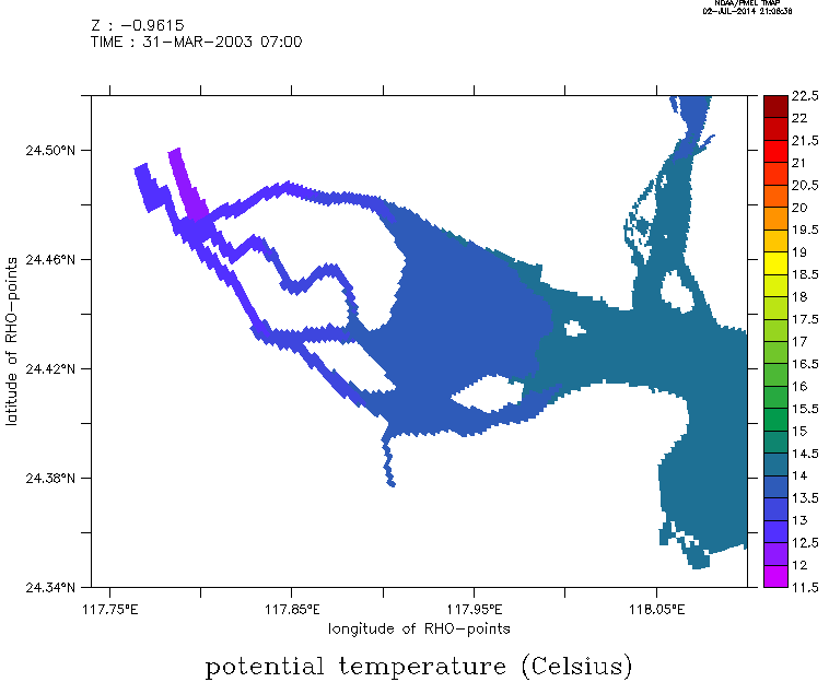

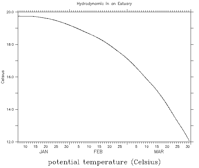

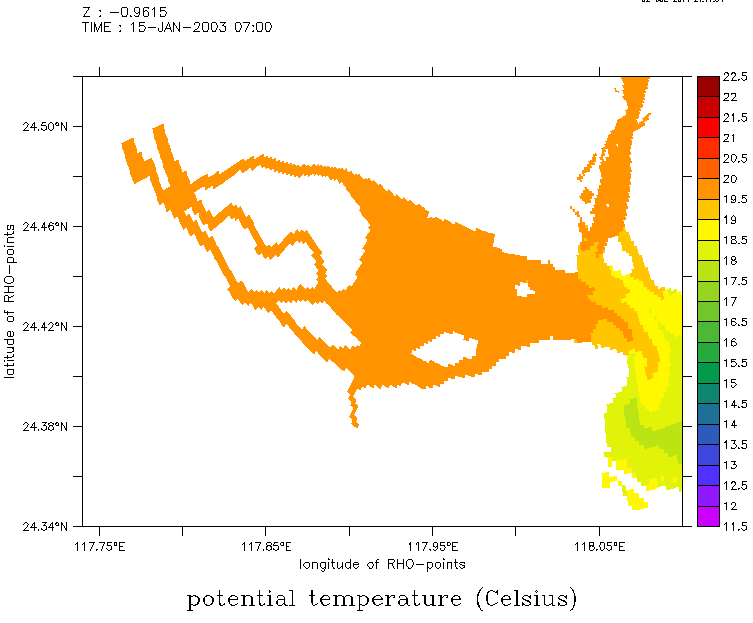

I'm running a case on a estuary with river runoff input.Let the Logical switch of point sources temperature 'LtracerSrc' to False.
But the temperature of the zone where point sources located decrease along the model run,and the low temperature water along the river flows downward .
After several days,the model Blowing up.
Like the figure show.
Hopes for your help.
thanks.

Re: roms river temperature problem
You have to set those LtracerSrc to True and provide tracer values for the incoming river flow. Otherwise you have a "downwind" advection scheme, known to be unstable. The only time it makes sense to turn LtracerSrc to False is on outflow from the domain (which could argue for LtracerSrc to be on for some sources, off for others).
