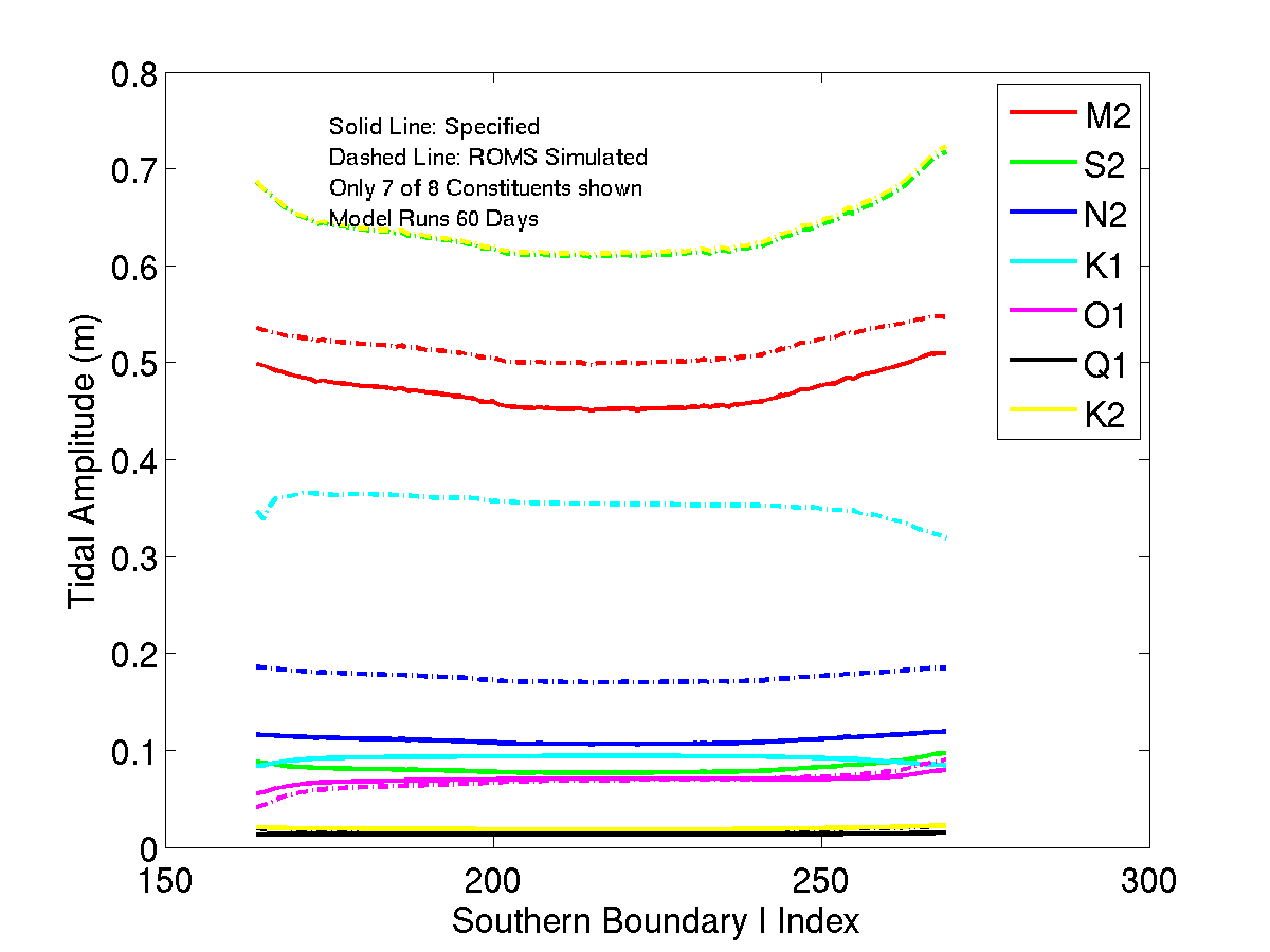

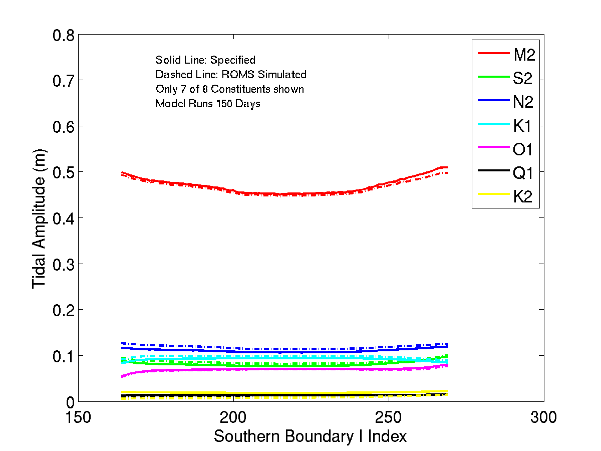

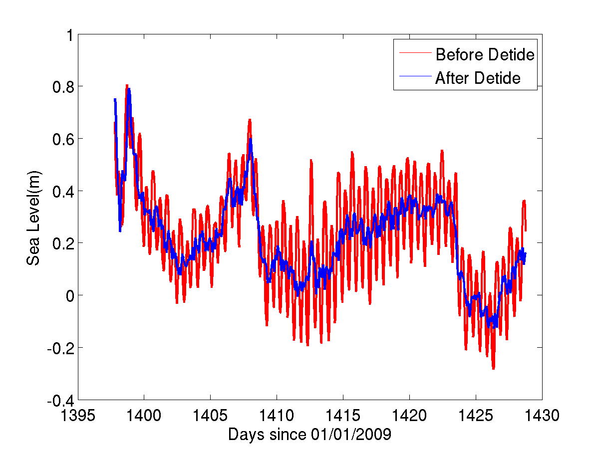

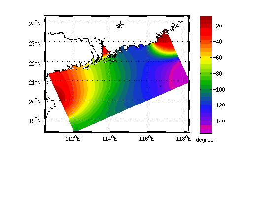

Re: tidal analysis of large output files
I think you can just put these tidal constituents (M4,M6 and M8) into the tide forcing file but set their amplitude to zero.
Attached is a matlab code to read the output tidal forcing files and convert the harmonic summation terms to phase and amplitude for each variable.
And a time series of zeta is posted here. The tidal analysis runs for about 150 days with 8 constituents in the Chesapeake Bay.
harm_roms.m
- (6.49 KiB) Downloaded 1564 times

I think the short simulation time may be the problem, as Hernan said. Attached are two figures with 60 days and 150 days of model runs with 8 tidal constituents in the CBOFS. The results are clearly different and 60 days are not enough to separate these tidal constituents. And the 60 days results look like that Rich described.

I follow wilkin's instruction to simulate tide only with M2 and S2 constitutes and the tide start time is set to 2000010100 ,then after three months running I use the harm_roms.m code provided by bzhang to analysis the expanded tide forcing file and got the tide_amp and tide_phase. but I don't know why the tide_phase values are all negative??
- cotide.jpg (29.92 KiB) Viewed 46683 times
Hi, WRH,
I see your simulated tidal phase is completely normal, the phase is out of atan2 in matlab and scaled by 180/pi. You just need to add a constant 360 degree to get a positive number. You can look at this paper for comparison: doi:10.1029/2002JC001451
