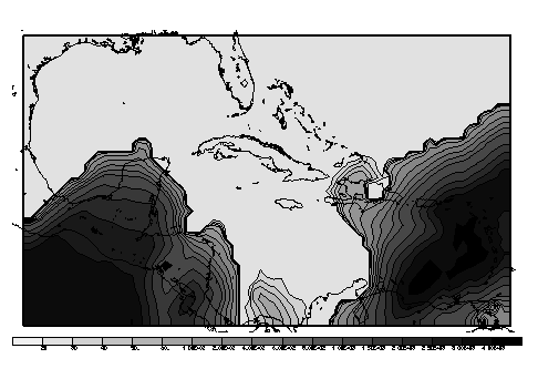

3) other problems using ETOPO2
grid and tolat seems ok, while not the bathtub.
this case is Caribbean, so the domain is
 Latitude range    8.73607540130615        30.2309589385986
 Longitude range   -98.2675476074219       -59.7324600219727
what's strange is that I saw topography and coastline about other area overlaped this domain(one can have a look at 1.png in the attachment), it is obviously not what I want but there is no error information at the command prompt.
I then checked the difference between dimensions of ETOPO5 and ETOPO2,
in ETOPO5, the latitude is from -90 to 90, longitude is from 0 to 180, then from -180 to 0.
in ETOPO2, the latitude is from -90 to ~89.97 as in ETOPO5, while the longitude is from -180 to 180.
I just wondered that whether the order in zonal of the dataset matters or not.
zhao
the domain is GOM, however you can see the coastline about east-south Asia.
