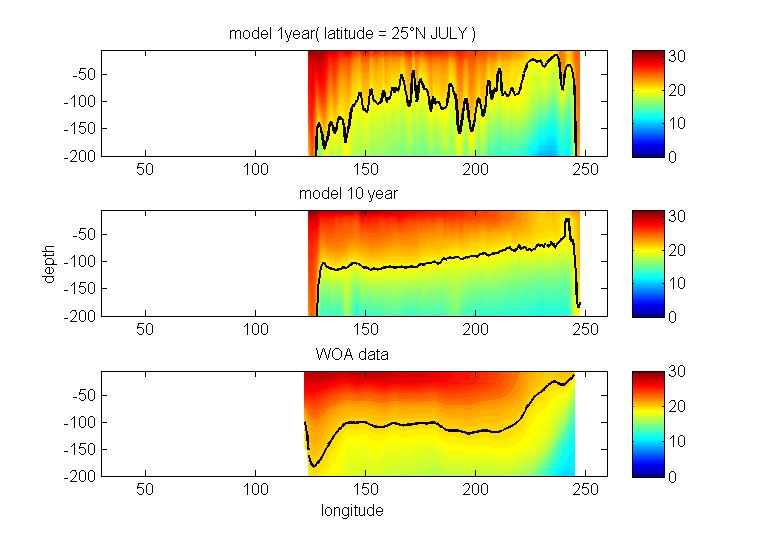

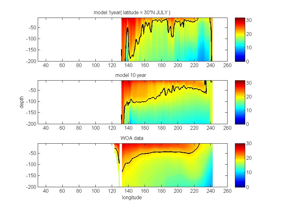

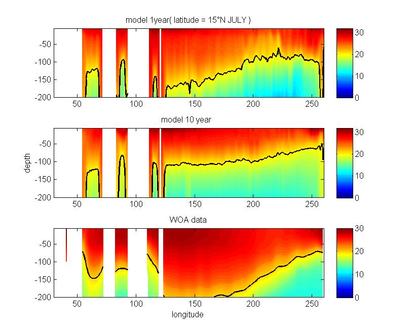

Dear ROMS users-

so, can anybody tell why i am getting bad Vertical mixing. Does radiations fields I am using are correct? is anything missing/wrong in cppdefs.h ?
