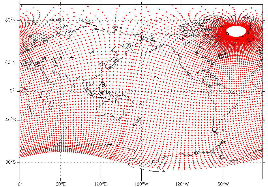

#4 Unread post by susonic »
Is there a toolbox to generate attached figure like domain?
Joonho Lee

Re: Circumpolar grid
#5 Unread post by Pysh »
Hi
May be this script? Sometimes it works normally :)
(Gurvan Madec, Maurice Imbard; A global ocean mesh to overcome the North Pole singularity; Climate Dynamics (1996) 12:381-388)
Cheers
Boris
