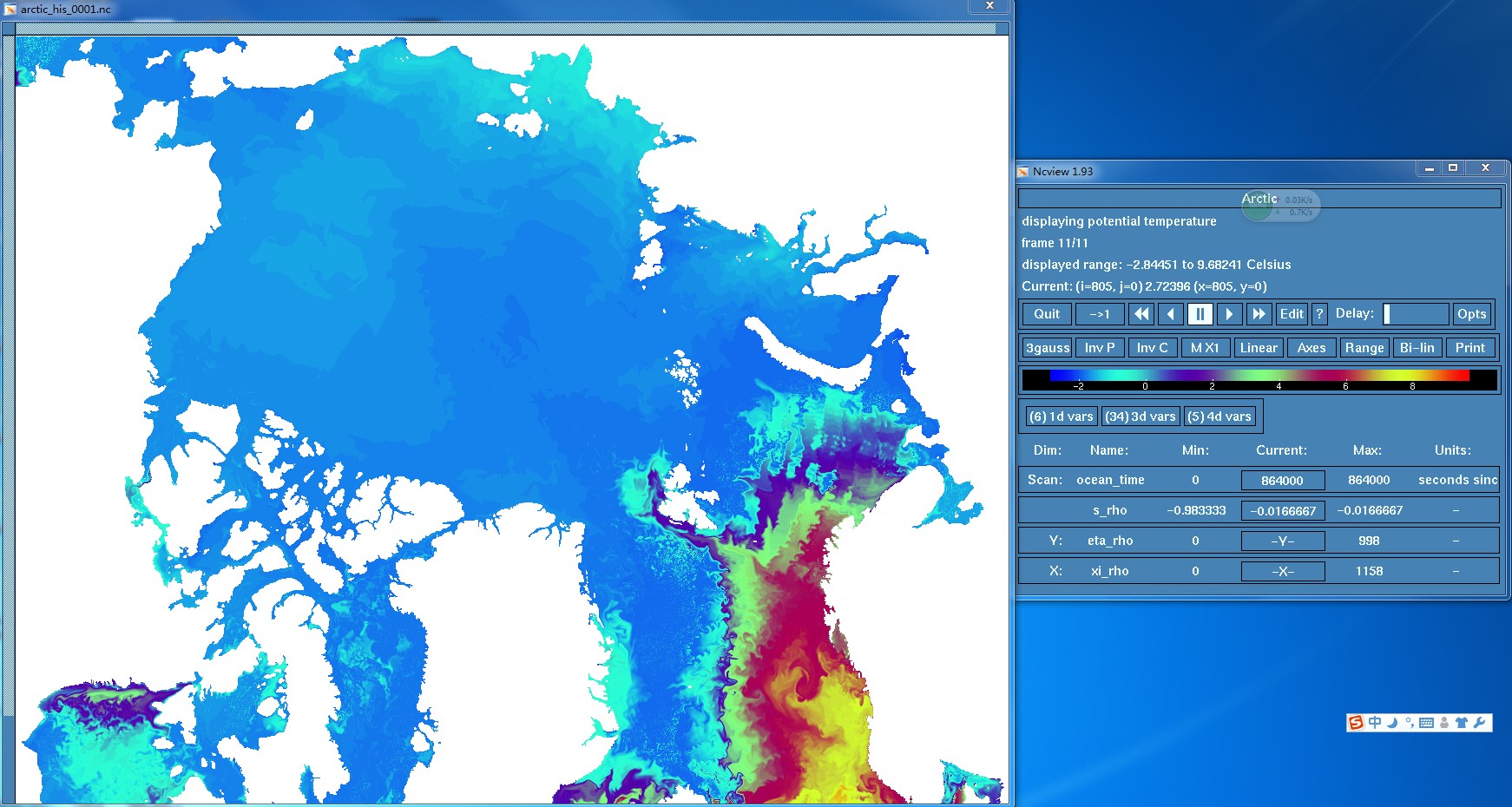

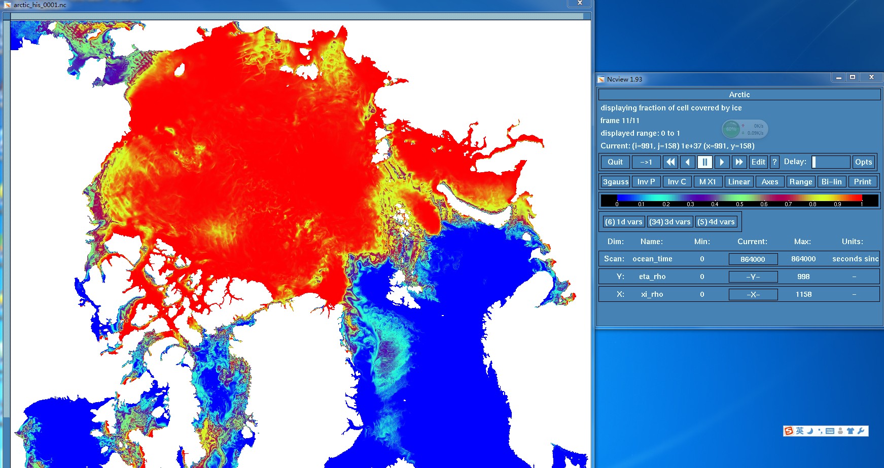

could anyone help me? i am in trouble when i make a climatology run in Arctic with ROMS sea ice.Fist, I make forcing file which contain many variabls include Pair Tair Qair Uwind Vwind lwrf_down swrad rain.The data i used is monthly average COADS data. my netcdf file attributes:

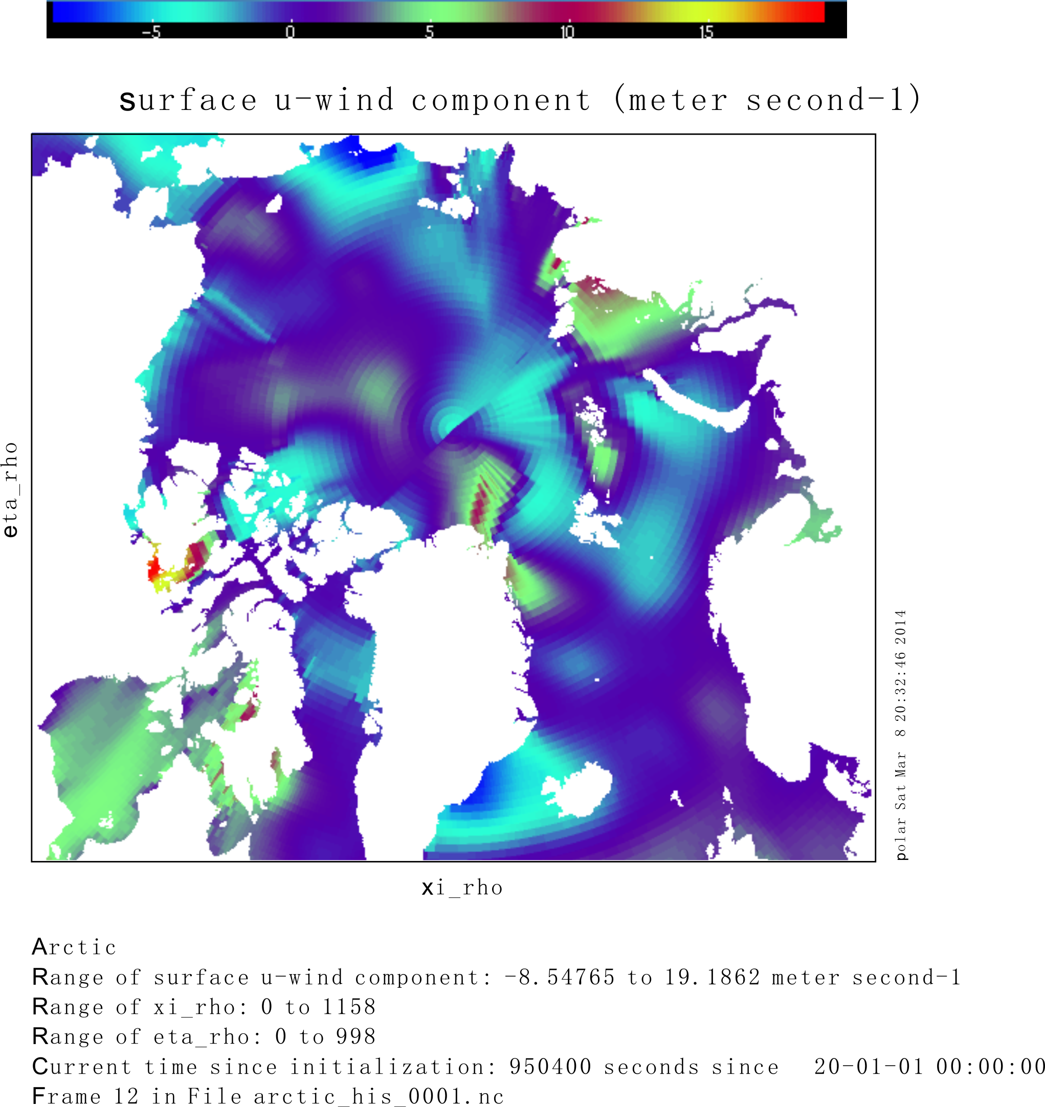

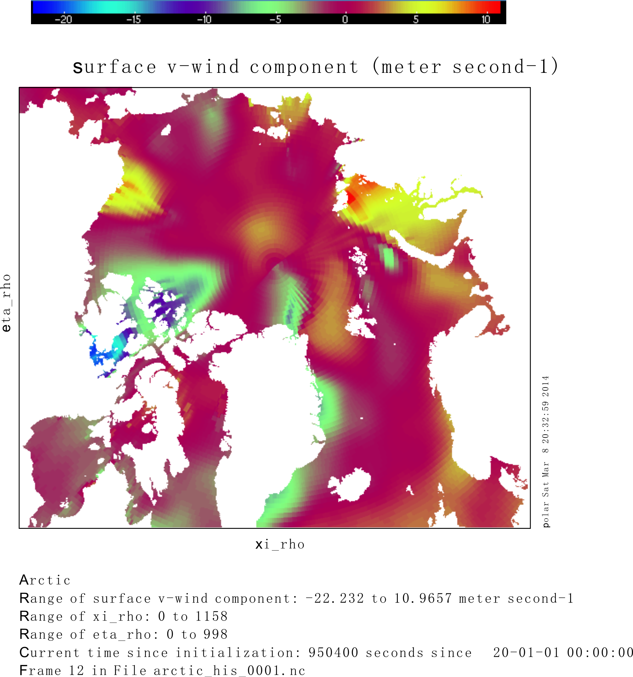

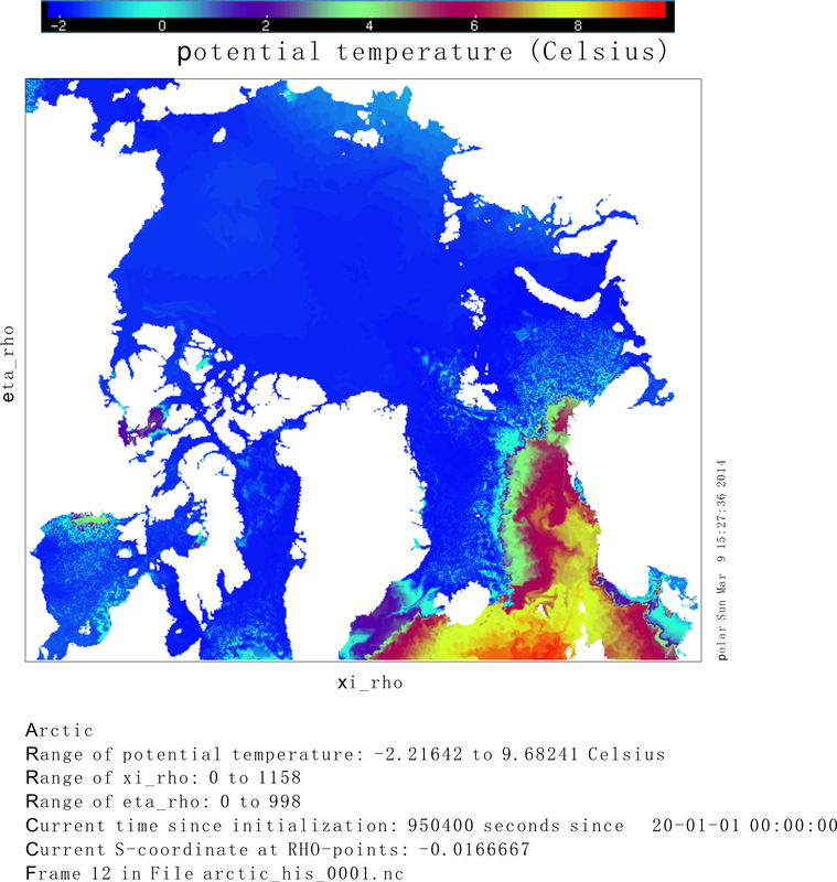

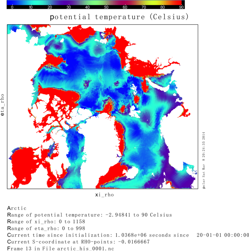

i set ice free at the beginning of model start. after integrated 12 days, SST can upto 96 degree centigrade. I check the latent,sensible and net heat flux which cumputed by bulk formula.It's not normal. the values of net heat flux are over 1000 at some regions which correspond to unnormal SST. I don't know why. it's look like that latent and sensible heat flux are vary sensitive to wind speeds. what cause simulated SST abnormal ? the forcing data i used ? or bulk formula? so I upload some figures for you to diagnose. I would appreciate it if sombody can figure it out. thanks in advance!
v component wind speed after integrated 12 days
u component wind after integrated 12 days

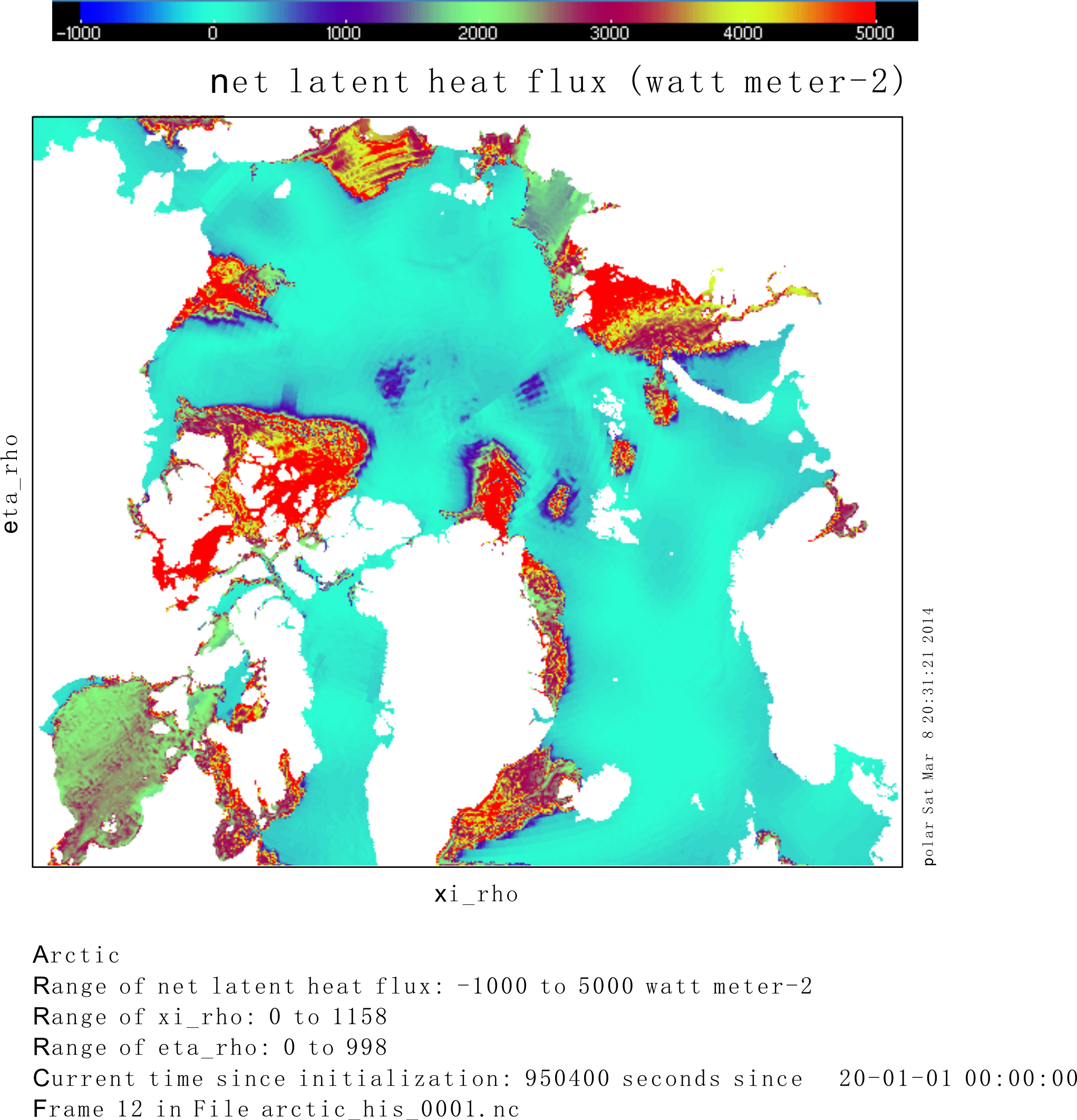

latent heat flux after integrated 12 days

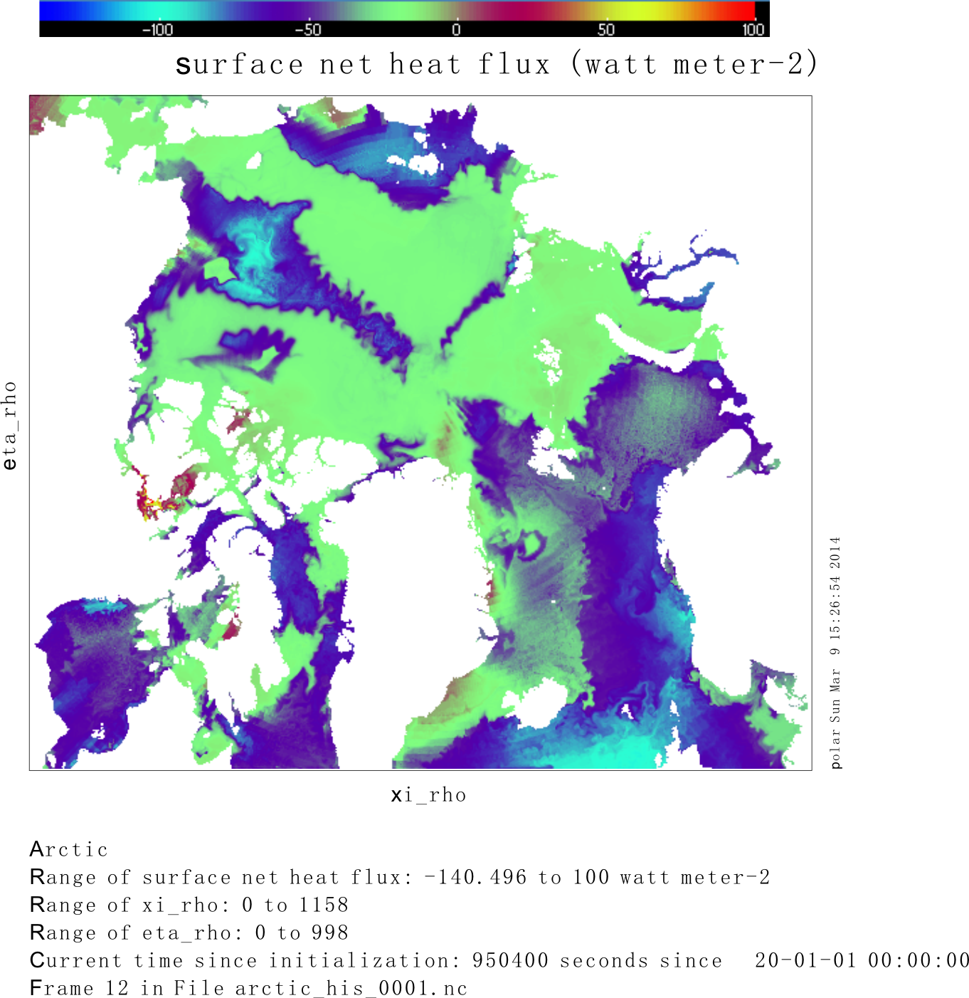

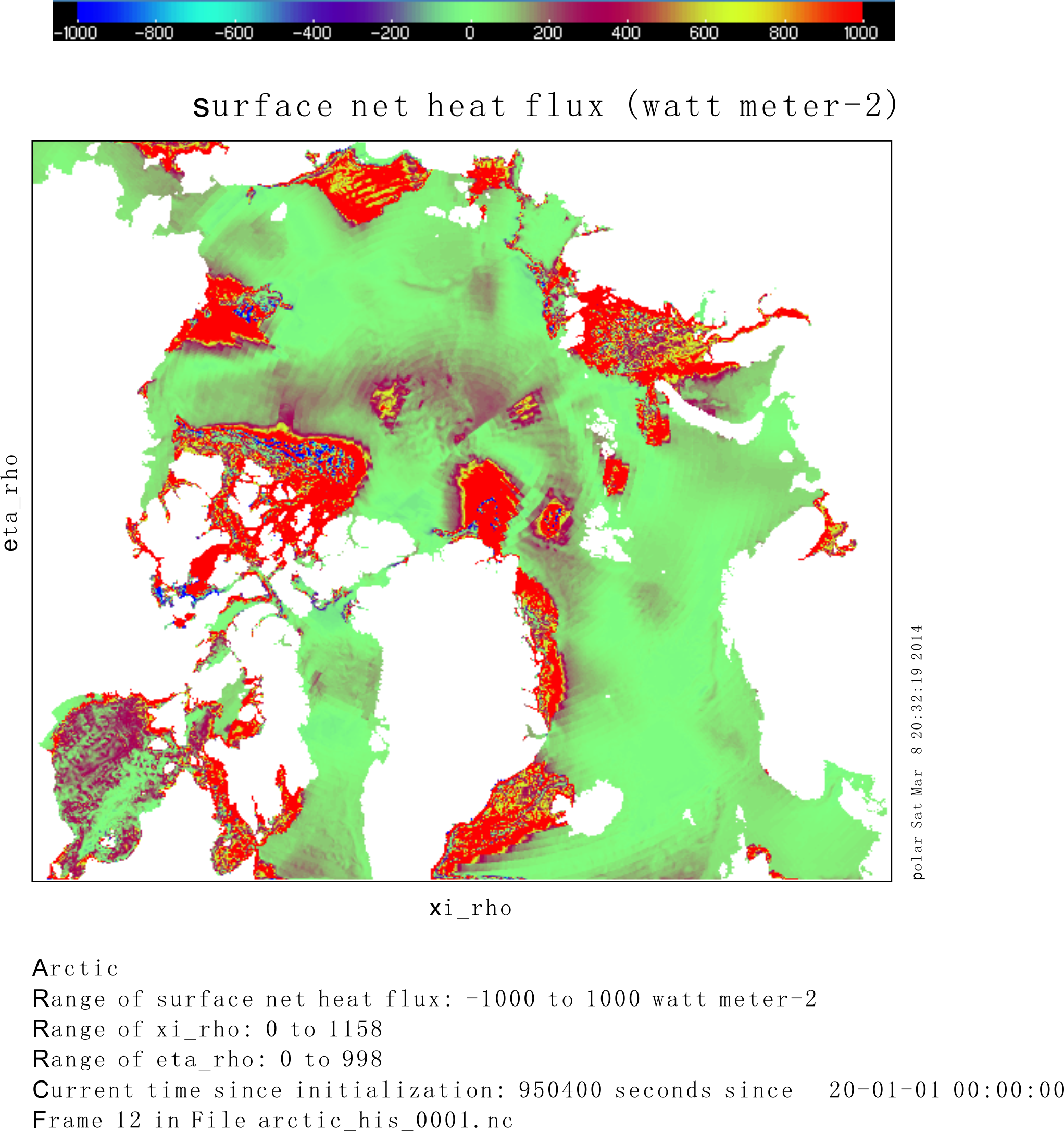

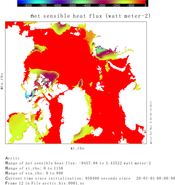

net heat flux after 12 days

Paul_Budgell
Posts: 19
Joined: Wed Apr 23, 2003 1:34 pm
Location: IMR, Bergen, Norway
Re: SST big proble use ROMS sea ice define BULK_FLUX
#2 Unread post by Paul_Budgell »
Looks like some issue with units. Have you converted sea level pressure from Pascals to Hectopascals (mb) in varinfo.dat?

What is really weird is that it seems the simulated SST result is normal now. please see the picture below. But the Pair i made is wrong. is'nt it? that make me confused!
why?
SST after integrated 12 days
net heat flux after integrated 12 days
