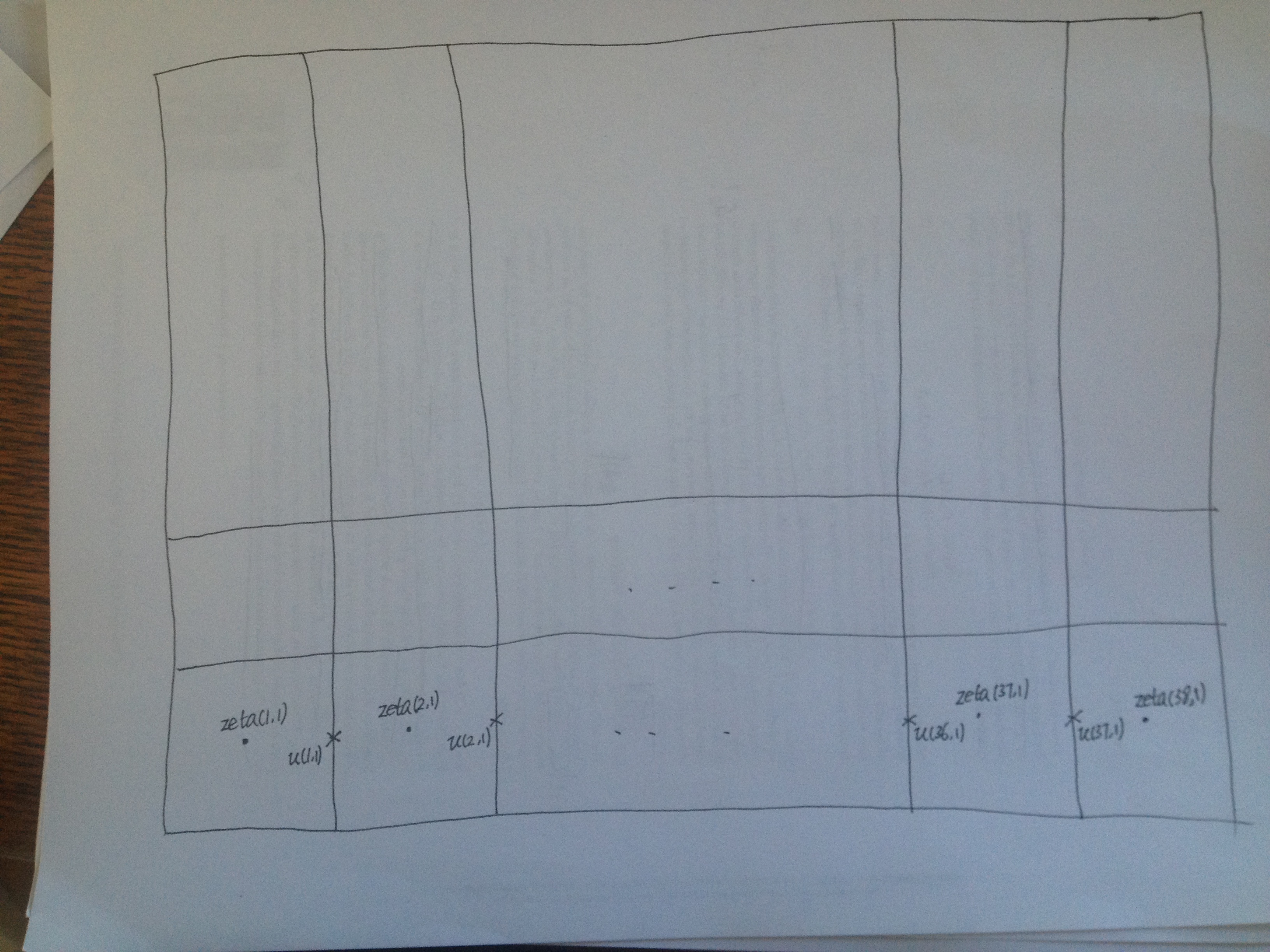

In ROMS, variables are dimensioned for a staggered grid, the numbering starting at i=0 for some, at i=1 for others. This is possible to do in Fortran. When reading ROMS input into other tools like Python and Matlab, all variables start with the same index. I don't remember what it is in Matlab, but in C and Python, all variables start at i=0. That means that preprocessing code must take that into account: the range of u indices becomes 0 to 36 instead of 1 to 37 while the zeta indices remain 0 to 37 for 38 values.

So does it mean ubar(1,:,:) in Matlab is the same as ubar(0,:,:) in Fortran? In the output, the length of the first dimension of u is 37, and zeta is 38.I think the positions of u and zeta in output are like the figure I upload. Am I right? If I am right, the problem is that, u(1,:) are all zeros, but zeta(1,:) and v(1,:) are not zeros. And when I calculate the continuity equation for the grids in the first row,such as grid (1,2), the continuity equation is not closed.
