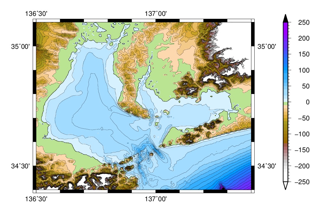

But the bathymetric data in ROMSTOOLS (from etopo2.nc) is not precise,so I replaced it by my bathymetric data, and created the new masking data.The precision is 0.005 degree in both longitude and latitude.By the way, I'm using MATLAB to handle netcdf file.

3) I did gentle smoothing of bathymetry, dirty quick way; i.e. find land higher than 20m (negative values) and put them == -20 i.e. in matlab: bad=find(depth<-20); depth(bad)=-20; That way you do not care about mountains, just expected region that could be flooded. Then I smooth modified bathy to get some decent rx0 ..
