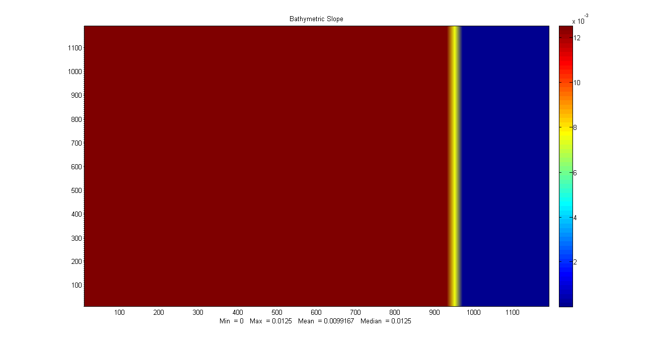

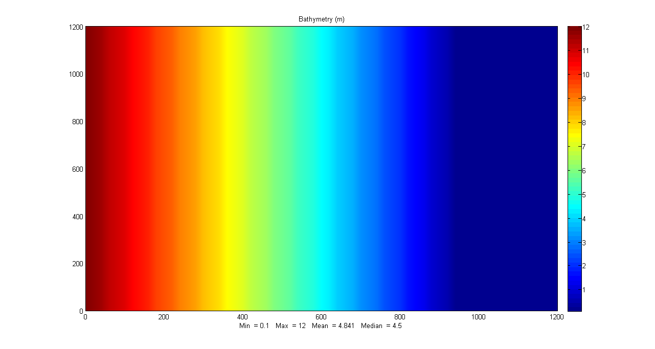

My case is about roms-swan coupling . The domain is 1200m*1200m, slope=1/8.
The max depth =12m , min depth =0.1m. I plot it with hslope.m, which can be found in attachments.

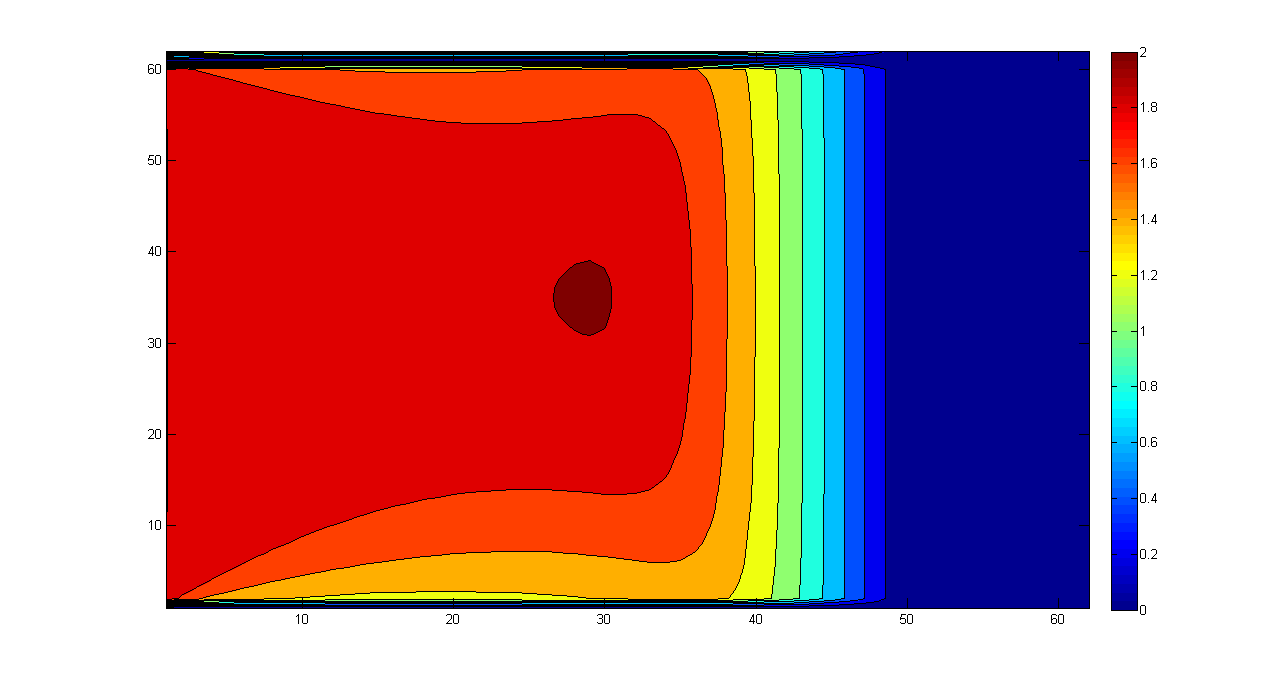

I find you are right ! I make some test case. The grid is Lm=60 Mm=60, if I set Nthreads(ocean) = 1
Nthreads(waves) = 7 , NtileI == 1 NtileJ == 1 ;the Hsig value in j=1 and j=61 are all 0. PIC-1

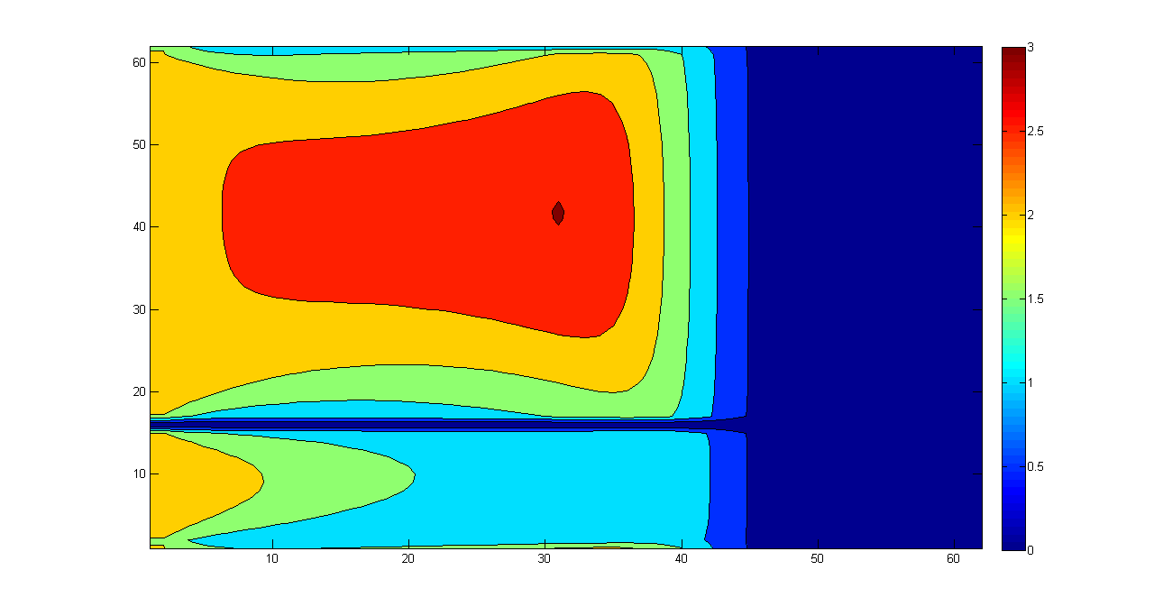

If Nthreads(ocean) = 4 Nthreads(waves) = 4 , NtileI == 1 NtileJ == 4 ;the Hsig in j=16 are 0.PIC-2

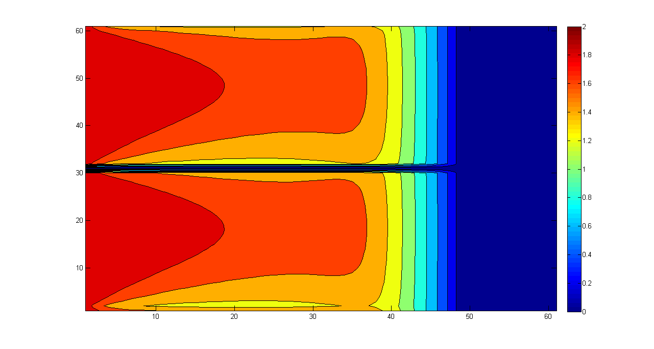

If Nthreads(ocean) = 4 Nthreads(waves) = 4 , NtileI == 2 NtileJ == 2 ;the Hsig in j=31 are 0.PIC-3
I aslo try to compile ROMS by two threads and set Nthreads(ocean) = 1 Nthreads(waves) = 1 , NtileI == 1 NtileJ == 1, the picture of Hisg like PIC-1. Is there something wrong in my case ? Or how should I set Nthreads ,NtileI and NtileJ ? Thank you !
