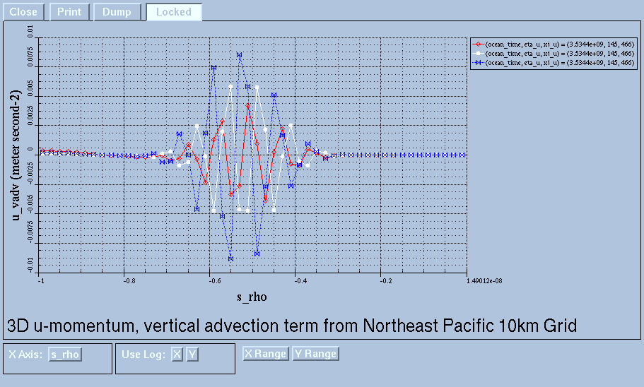

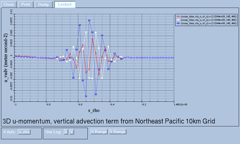

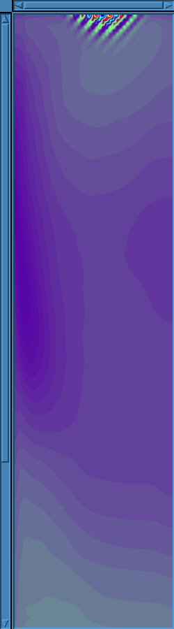

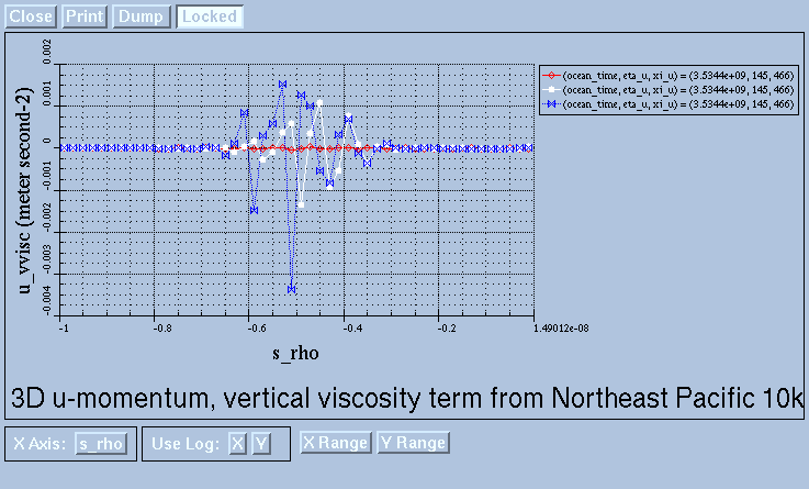

I'm going to attach some images, showing trouble in the vertical advection of u, taken when restarting just before the trouble. Has anyone ever seen anything like it? Have any advice? Is it time to smooth the heck out of the bathymetry? I've seen this sort of trouble on and off over the years and it has been hard to sneak up on because in other domains it would go away on restart, even with PERFECT_RESTART.
Instability in vertical advection
- Posts: 1386
Re: Instability in vertical advection
How is the profile of temperature, salinity, or density looks at that point? It will be also useful to plot the velocity shear, N^2, and Richardson number at that point. Obviously, something is wrong in the vertical parametrization. The vertical viscosity coefficients is kind of high at the point. You just need to investigate who is doing it. The best thing in these case is to look at the profile of velocity shear and N^2. Obviously, the model is blowing up with that high velocity.

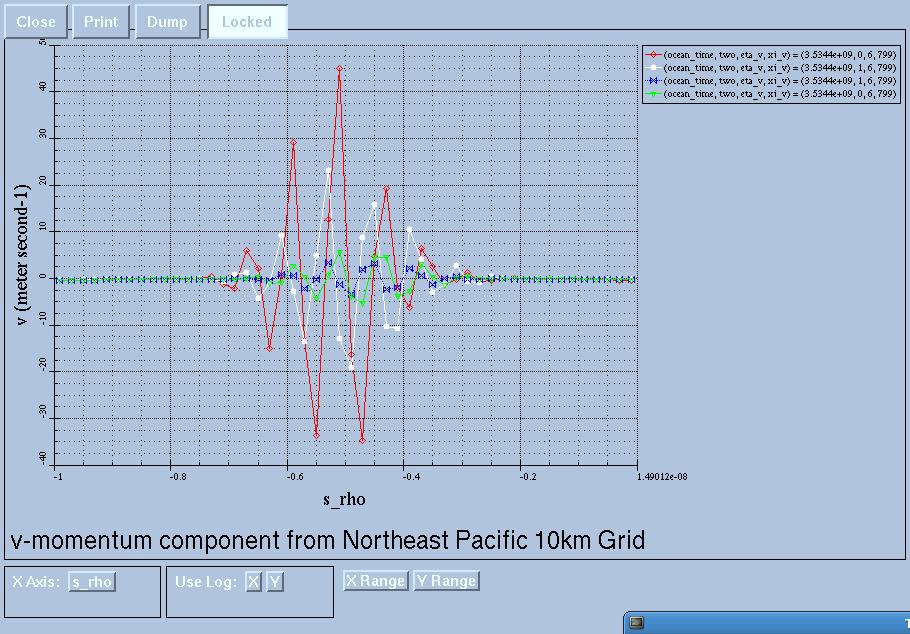

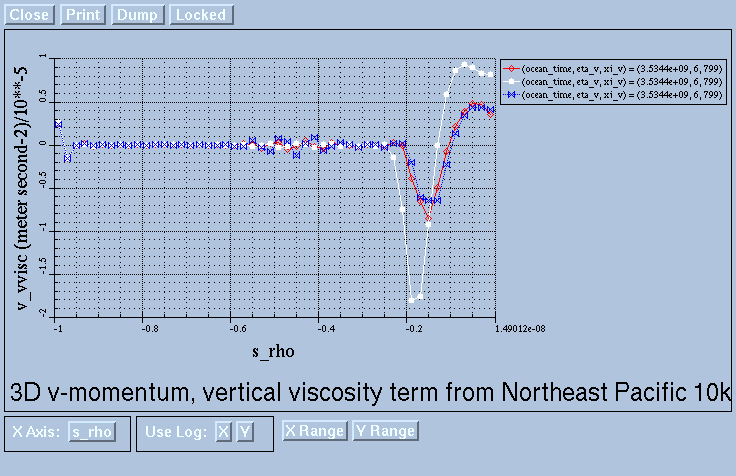

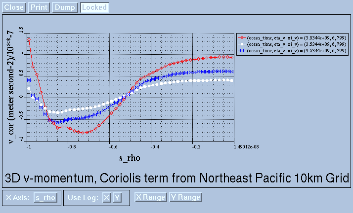

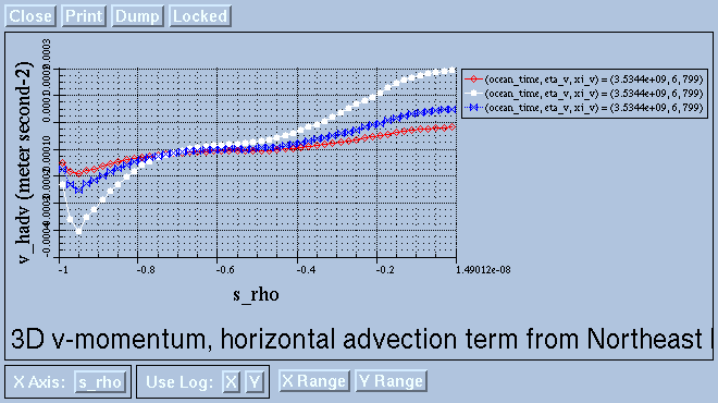

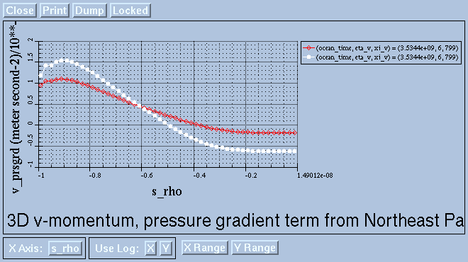

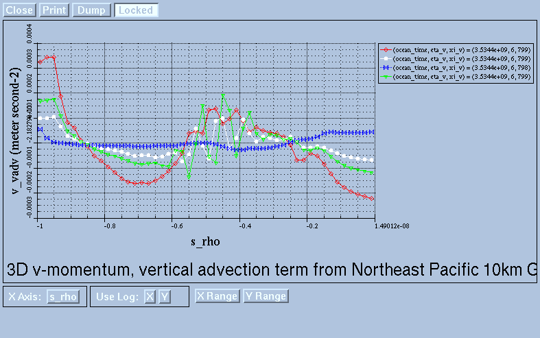

I've managed to convince myself that it is vertical advection causing the trouble. Every other field looks fine until well after v goes bad. I saved a restart file before the v-velocity looks visibly bad, then did diagnostics on it every timestep. Here are the different V components (v_hvisc was too small for ncview to plot at that point).
You ask if it goes bad near the boundaries. The point shown is at j=7 (6 in ncview coordinates), but it is closer to an island than the boundary. Its other favorite place to go bad is also quite close to an island. My next attempt will involve more bathymetry smoothing.
- V at station

- v_hadv
- v_hadv.png (6.93 KiB) Viewed 8191 times
- v_cor
- v_cor.png (8.06 KiB) Viewed 8191 times
- v_vvisc
- v_vvisc.png (8.15 KiB) Viewed 8191 times
