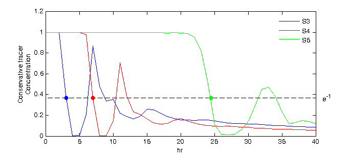

It is true that the dye may re-enter the domain after it's flushed out. I think a practical way to deal with it is to define residence time at each location as the time it takes for the dye concentration to FIRST go below 1/e of the initial value. The dye might get re-entrained back into the domain, and formed a second peak in concentration before declining again, but only the first drop should be used to calculate residence time (see attached figure as an example). For more detail, please refer to Figure 10 and 11 in the following reference:
Zhang Z, Falter JL, Lowe RJ, and Ivey G. (2012) The combined influence of hydrodynamic forcing and calcificationon the spatial distribution of alkalinity in a coral reef system. J. Geophys. Res. 117, C04034.
- The residence times are indicated by solid circles in this figure.
- Fig13.png (5.45 KiB) Viewed 17556 times
