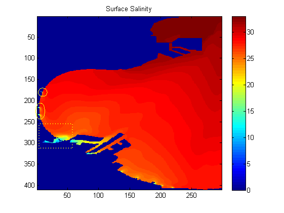

I'v had the same problem long time ago. I have a extensive shoal as lanerolle said that can be wetting/drying along with tidal flood/ebb. As commonly think the point source/river would be connected to the sea with a permanent water line/flow even when reaching a low tide. But in roms we alway get the point source isolated(some cells would be wetted adjacent) during ebb for the point sources were usually located far from the water-land interface(swing with tidal behavior). Sometimes, i may want to excavate a pathway for the river to connect with the open water, by changing the depth values(along the flow line) from ~ 0.5 m to a bit more large ones, but never to be done.
In my application , i have ~ 10 point sources flow into a bay. I would like to show you a figure that can explicitly point this problem out. In the figure the river flow is connceted with open water on and off, but the small drainages would be totally isolated when tides run offshore and reconnected when towards land. If this the case, the points flow into the bay at just some timesteps. Is that can make sense? I dont think so and dont find a better way to treat it.

- the dashed rectangle is a river and small ellipse are outflows
- River flow.png (11.14 KiB) Viewed 10492 times
