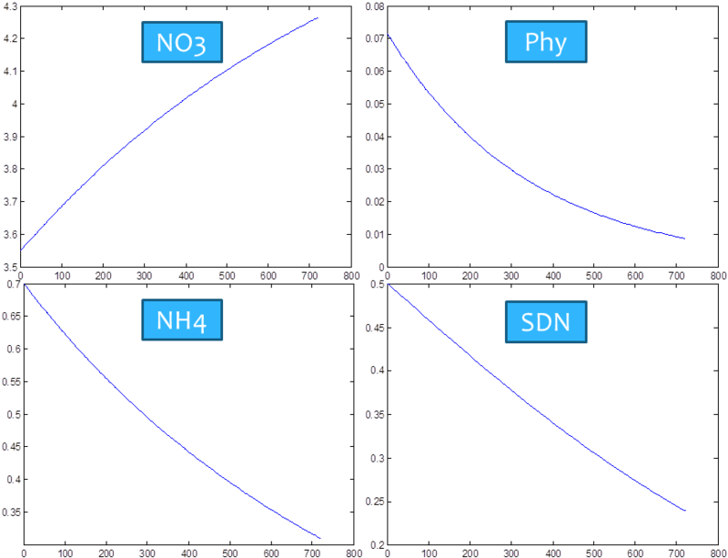

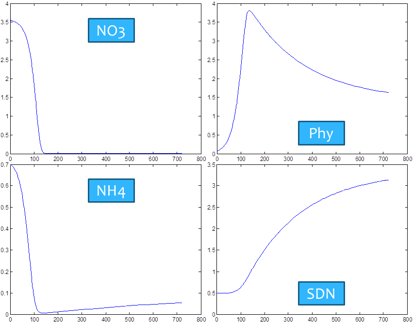

Before start out on my way to run the realcase physical-biological coupled model, i have successfully run the bio_toy test case. I looded into the results and also the input forcing files, to comprehend the relationships btw variables that on different trophic levels and relationships btw dirving forces and variables. Learned from this case and united with textbook knowledge, i thought i could grip the majority features of this coupled model.
Then i took my realcase into practice. Based on the well-calibrated-validated physical model, i put seven, viz. NH4,NO3,Phy,Zoo,LDetN,SDetN and Chlo, state variables in with all forcing drivers (u,v-wind,srflux,airp,airt,airq,lrflux and tides) imposed on. State variables are all initialized constants over the domain in both directions(ini-values:NH4=0.7,NO3=3.55,DetN=0.5,Zoo=0.2,Chl=1.0 and Phy=1.0, some of them are derived from investigation,some are estimated value). But as were outputted, the results show some unreasonable biogeochemical processes. The most remarkable is the process of Nitrification for NH4 to transform into NO3. Then i run a set of tests with values changed from the last case, but all run into a phenomena with which the NO3 consumed up and never incerase a bit even with Nitrification defined. Im now can understand what Prof. Fennel said that with a constant light nitrification effectively shut off, but in my realcase i employed light data from NECP and with diurnal fluctuation indeed. Why it behaves like the one i mentioned in first post of this thread?

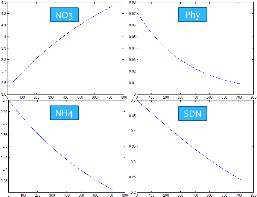

5. In your second post, your first figure shows NO3 increasing with time and all other N pools decreasing. Rather than being the "good" run, this might be the "bad" run---i.e. this is what would happen if there were no light at all. The second figure, where NO3 depletes, is more what I would expect for a tropical mixed layer.

Yes, i can ensure that the nitrogen is conserved with time, i culculated the nitrogen anomaly (at present in test case is the sum of NO3,NH4,SDN and Phytoplankton) at every timestep, to find a largest value reaches an order of magnitude for -7, i.e. ~ 2.5*10 ^ -7. This can be neglect i think in our modelling.Is domain-averaged total Nitrogen (NO3 + NH4 + SRN + ...) conserved with time in your simulation? That is one way to make sure sediment denitrification is not occuring in your model, which I believe you do not want (yet).
Frankly, i can learn from the second figure somewhat that phytoplankton growing rapidly along with nutrients consumed at a hing-speed. What i want to suspect in this case is no NO3 to be produced. As Katya said, i was not expected to gave the system a constant light intensity. But i could not understand from the first figure/case with DIURNAL_SRFLUX defined to introduce a day-night variation. I want to know why Phy decrease from initiation without even a minimum increase with NH4 been uptaken. Would that be the reason for much larger nitrification rate? I will have a try...In your second post, your first figure shows NO3 increasing with time and all other N pools decreasing. Rather than being the "good" run, this might be the "bad" run---i.e. this is what would happen if there were no light at all. The second figure, where NO3 depletes, is more what I would expect for a tropical mixed layer.
