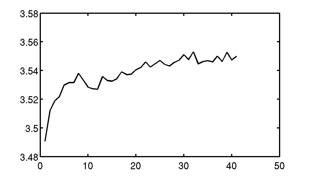

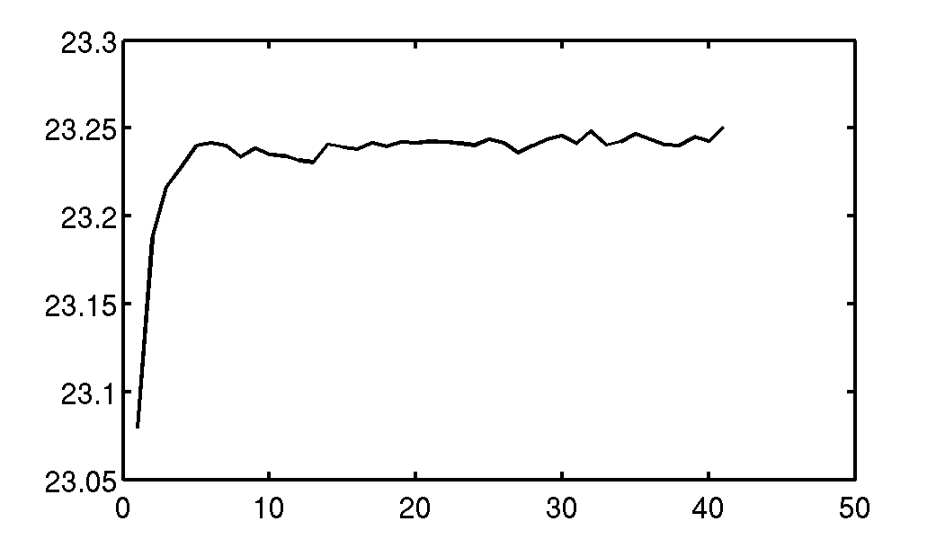

Attached figures are the yearly mean, surface and bottom level avergaged temperature variation for 41 years.
The model domain is North pacific basin (E98~W76, S20~N65).
bottom level averaged temp variation
surface level averaged temp variation
Joonho Lee
Re: cuase of the temperature rise
I don't have recent experience with either product you mention, but we switched from NCEP to CORE2 for better heat fluxes over the North Pacific. Also make sure you have the albedo set the way you want, so that some heat flux reflects back to the atmosphere.
Our latest attempt was with MERRA over the Arctic where we grew too much ice. It's a fine line!
