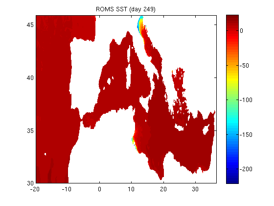

Dear ROMS users,
I am running model with ERA40 daily data(00hrs)for 1995-2000. I am getting negative temperature. I don't know why it is giving such -ve temperature.
I attached here one figure from 249 day and also log file.
any suggestions/comments ?

Since the most extreme negative temperatures are located at the coasts: Have you checked if maybe the land-sea-mask of the forcing does not exactly match the one of your ocean model? You can turn on surface net heat flux output to see if you lose the heat toward the atmosphere.

Dear julian,
I fix the problem. The problem was in input radiation flux. Model runs fine and no more negative temperatures.

Hi Shou,
I replace "Surface thermal radiation" with "Surface thermal radiation downwards" from ERA40 data set.
regards

Notice that the
FAQ for the ECMWF ERA dataset has the following information:
What are the definitions of the radiation fields?
It is always a good idea to read the documentation about any dataset carefully.
- Surface solar radiation downwards is the incident solar (shortwave) radiation and surface solar radiation is the net solar radiation. Surface net solar radiation, clear sky is a hypothetical field assuming no clouds.
- Surface thermal radiation downwards is the incident thermal (longwave) radiation and surface thermal radiation is the net thermal radiation. Surface net thermal radiation, clear sky is a hypothetical field assuming no clouds.

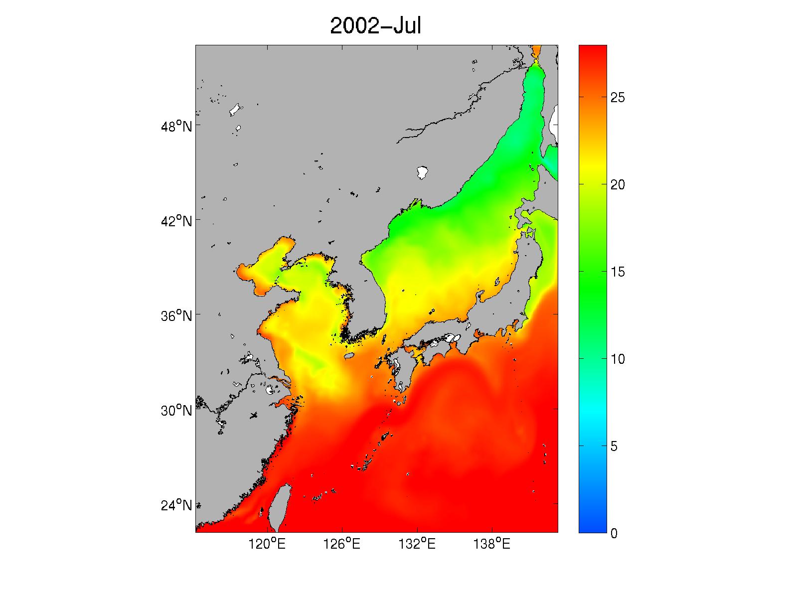

Hello Arango,
I have got the same problem when I simulated Bohai Sea. But I also found the other problem is that sea water was over heated along the coast of Bohai Sea in summer, such as

According to the figure and question "xiaozhu557" posted here. The so called "over-heated" coastal waters are his/her major concern.
Yes, the waters are warmer here. But, the temperature is still in reasonable range, and this implies that the wrong thing is not that strongly related to the coding or numerical algorithm of ROMS. You may want to refer to the figure given by "mashinde" at the very top and please note the differences. Then, I suggested "xiaozhu557" to check the forcing file and the flow field.
I'm not an expert in Bohai Sea studies and my study area is in the ECS.
But, in general, in the coastal areas, where the waters are very shallow (<10m in Bohai I believe), the waters are easily mixed well especially when we also take tides into consideration. The warmer waters heated by the heat flux in the surface layers occupied the coastal areas in the Bohai Sea, and possibly in the entire water column. This is a possible reason for that warm coastal water. This warm water may also change the local pressure field, and then the geostrophic currents and Ekman processes (related to upwelling/downwelling processes). It is not that easy to find out the complicated interactions among these processes, I think.
Secondly, when there is river plume (Yellow River), the warmer and fresher river discharges flow along the Bohai coast, and provides another source of warm waters. Buoyancy effects of the plume waters to coastal current are complicated also, and of course, the remote forcing from the ambient current and interaction between Bohai and Yellow Sea is important.
