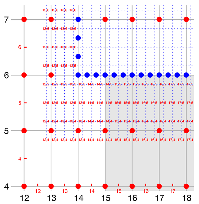

Contact Regions and Contact Points
<wikitex> A contact region is an extended section of the grid that overlays or is adjacent to a nested grid. A contact point is a grid cell inside the contact region. The contact points are located according to the staggered Arakawa C-grid horizontal positions. Therefore, we have contact points at the ρ-, ψ-, u-, and v-points. However, the ψ-points are only used to define the physical grid perimeters within a contact region. ROMS does not have state variables located at ψ-points; vorticity is not explicitly specified in the governing equations. In a nested application, there are (Ngrids-1)*2 contact regions. Each contact region has a receiver grid and donor grid. The contact points of the receiver grid are processed using the donor grid cell containing the contact point. The contact points are coincident if the receiver and donor grids occupy the same position, p = q = 0 in diagram below. If coincident grids, the receiver grid contact point data is just filled using the donor data. Otherwise (if not coincident) the receiver grid data is linearly interpolated from the donor grid cell containing the contact point.
Here, the suffixes dg and rg are for the donor grid and receiver grid, respectively. The horizontal interpolation weights are as follows:
- Hweight(1,:) = (1.0 - p) * (1.0 - q)
- Hweight(2,:) = p * (1.0 - q)
- Hweight(3,:) = p * q
- Hweight(4,:) = (1.0 - p) * q
These horizontal interpolation weights are computed outside ROMS and read from the contact points NetCDF file. Then, the contact point for a 2D state variable in the receiver grid is computed from the donor grid as:
- V(Irg, Jrg) = Hweight(1,:) * F2D(Idg, Jdg) +
- Hweight(2,:) * F2D(Idg+1, Jdg) +
- Hweight(3,:) * F2D(Idg+1, Jdg+1) +
- Hweight(4,:) * F2D(Idg, Jdg+1)
If coincident contact points between data donor and data receiver grids, p = q = 0,
- Hweight(1,:) = 1.0
- Hweight(2,:) = 0.0
- Hweight(3,:) = 0.0
- Hweight(4,:) = 0.0
and
Notice the duality of a ROMS nested grid: data donor in one contact region and data receiver in its conjugate contact region. The exchange of information is always two-way. This explains why we prefer to use the donor and receiver categories instead of the usual parent and child descriptions found in the literature.
