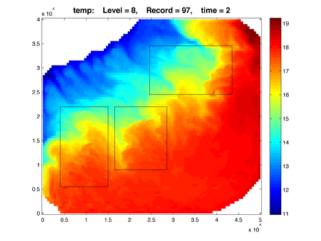

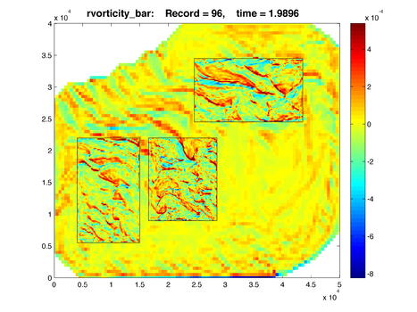

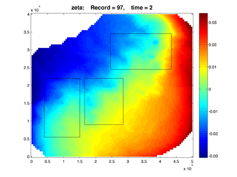

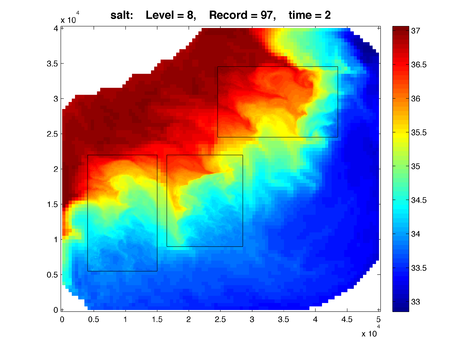

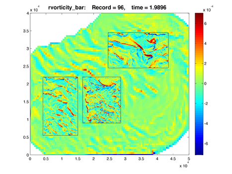

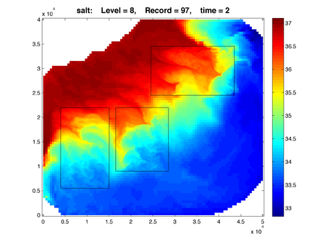

The plots below show the results after 2 days of simulation for one-way and two-way nesting configurations. They are plotted with Matlab using the script plot_nesting.m. The refined solutions (b, d, and c) are overlayed on top of the coarse grid (a). The color map is rendered using shading flat, meaning there is no interpolation between pixels in the color maps. Click the figure to see a more detailed image. On the resulting page a link to the full resolution image is provided.
The figures below were created in Matlab using the following commands:
 >>  Gnames = {'lake_jersey_grd_a.nc', 'lake_jersey_grd_b.nc', 'lake_jersey_grd_d.nc', 'lake_jersey_grd_c.nc'};
>> Anames = {'lake_jersey_avg_a.nc', 'lake_jersey_avg_b.nc', 'lake_jersey_avg_d.nc', 'lake_jersey_avg_c.nc'};
>> Hnames = {'lake_jersey_his_a.nc', 'lake_jersey_his_b.nc', 'lake_jersey_his_d.nc', 'lake_jersey_his_c.nc'};
>> G = grids_structure (Hnames, Hnames);
>> F = plot_nesting (G, Hnames, 'temp', 97, 8, 1, true);
>> F = plot_nesting (G, Hnames, 'salt', 97, 8, 1, true);
>> F = plot_nesting (G, Hnames, 'zeta', 97, 8, 1, true);
>> F = plot_nesting (G, Anames, 'rvorticity_bar', 97, 8, 1, true);
