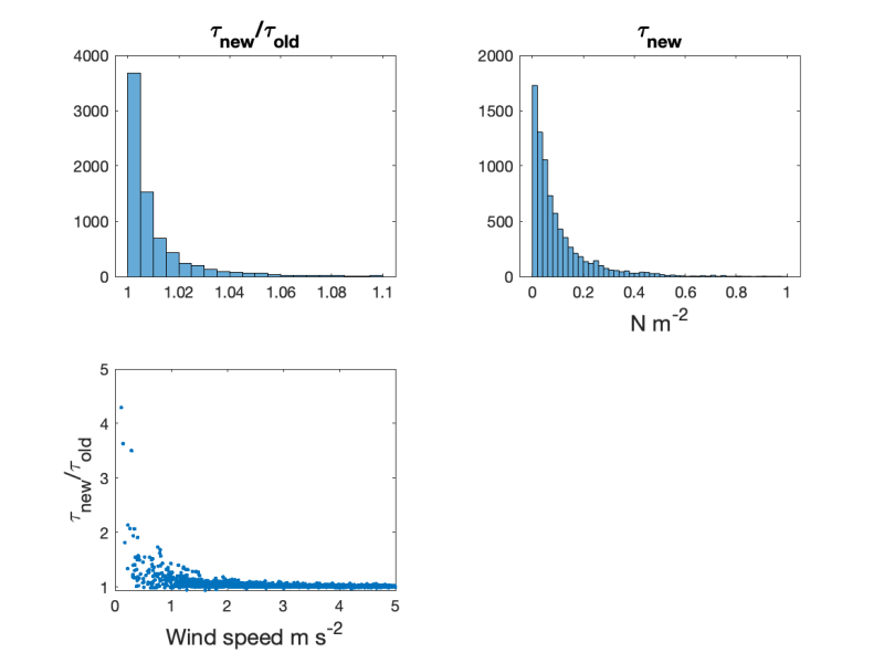

However, here Wspeed is wind speed augmented by a factor for wind gustiness. In earlier code ...
          Wspeed=SQRT(Wmag(i)*Wmag(i)+Wgus(i)*Wgus(i))
Thus, the denominator in the unit vector normalization, which should have been simply Wmag, is too large and the output sustr,svstr are slightly less than the magnitude from the COARE calculation.
For a simple 1-D simulation forced by ERA5 fluxes in the Mid-Atlantic Bight the error incurred is at most 6% (see plot below). Typically, it's no more than 1%. The error is greatest at lowest wind speeds when the gustiness can become an appreciable fraction.
So - no cause for alarm! But this will be corrected in a soon to be updated release of bulk_flux.F that implements the COARE 3.5 version from Edson et al. (2013) that performs better at strong wind speeds.
