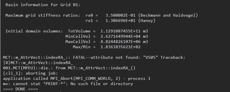

Hello,
We are currently using the ROMS-SWAN coupled model. The COAWST version we're using is 3.8, and there are no issues when running ROMS or SWAN individually. However, when attempting the coupling, especially with #define WEC_VF, we are encountering the following message.
For your information, we had no problem running Rip Current example case with cpp WEC_VF on.
Can anyone lead us in fixing this issue?
Thank you!
Joonho Lee
