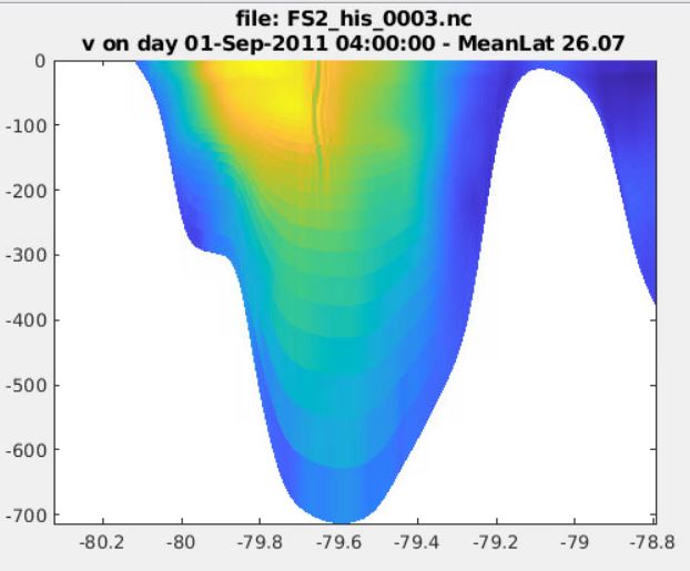

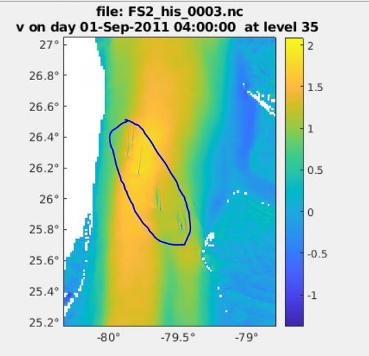

Hi everyone,
I am running a one-way and two-way nesting model (5x refinement) where the child grid focuses on a strait with a high N-S velocity. However, after like 2 hours into the model run, there are observable stripes and mark on the v surface plot, and this extends down to the cross-sectional plot which causes a very significant stripe. These marks and stripes are not observed in the same area in the parent grid. I have tried several things like reducing the time step, reducing NDTFAST, trying different schemes like LMD, GMD, also trying different advection schemes like HSIMT, C4... I am indeed stuck on what next to do. I have attached the images and the header file. I will appreciate any help.
