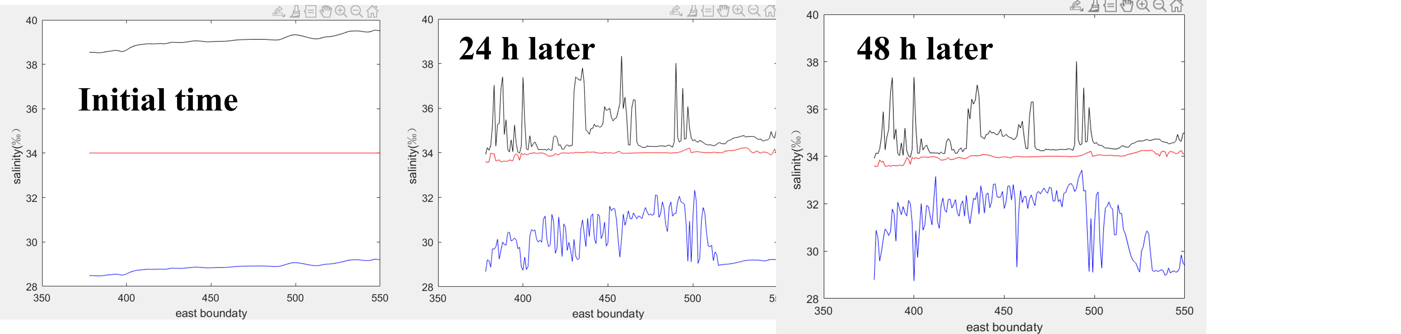

For example, for the initial time, modelling results corresponsd well with the initial condition input:
But at the first time (24 hours later) the boundary input (bdy_22):
Anyone knows why at the first input time of the boundaty files, the modelling results are very different from my boundary input? THANK YOU VERY MUCH!

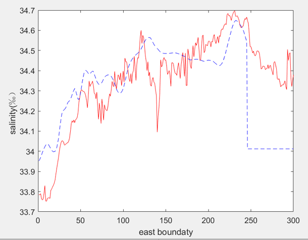

(1) In the previous question, I used the RadNud boundaries for the temperature and salinity. But the modelling results at the forcing time difference with my boundaty input files. Is this normal and possible?

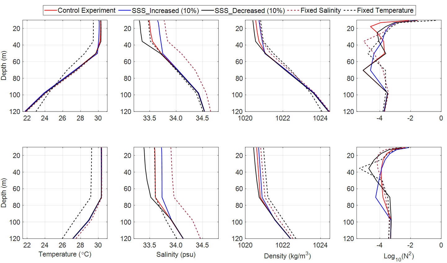

(2) Actually, this problem troubles me for a long time. I did lots of tests. For example, I increased or decreased the sea surface salinity by 10% (i.e., 34‰, up tp 37.4‰ or down to 30.6‰) in all the initial and boundary conditions. When I analyzed the modelling results, I found the increase or decreanse of the sea surface salinity only changes a little (i.e., 0.3-0.5 psu ) shown in figure. Is this correct?
I found that both the increased and decreased sea surface salinity (SSS) at a boundary would slowly align with the normal boundary, and not affected by my increased or decresed SSS boundary shown the figure.
I look forward to your reply. Thanks again!
