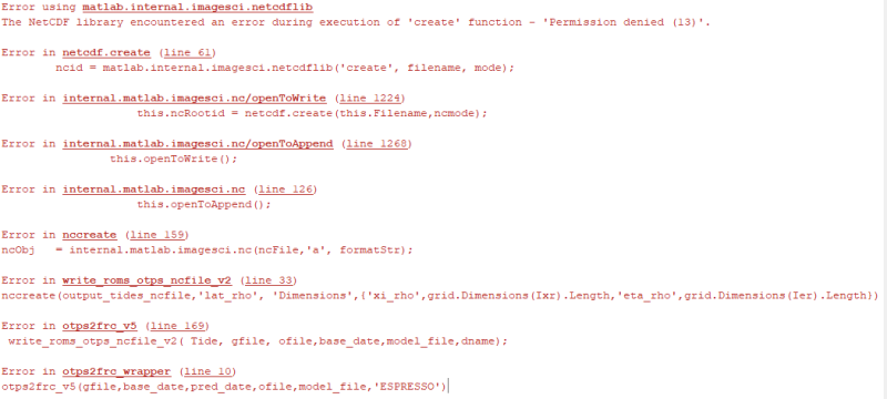

Below down i uploaded my grid file and otps2frc script and my error message as picture. I cant upload any other files because size is too big.

The error says "Permission denied" which suggests you are trying to write to a non-existent directory or you lack the permissions to create files there.
Matlab has great debugging tools. Try:
>> dbstop in write_roms_otps_ncfile_v2
and when Matlab pauses there, check what directory you are in
>> pwd
and whether you can make files there, e.g.
>> system('touch foo.txt')
>> dir('foo.txt')
Before line 33 when your error was triggered, write_roms_otps_ncfile_v2 writes an information message:
which may be informative. You didn't show that report in your post.
