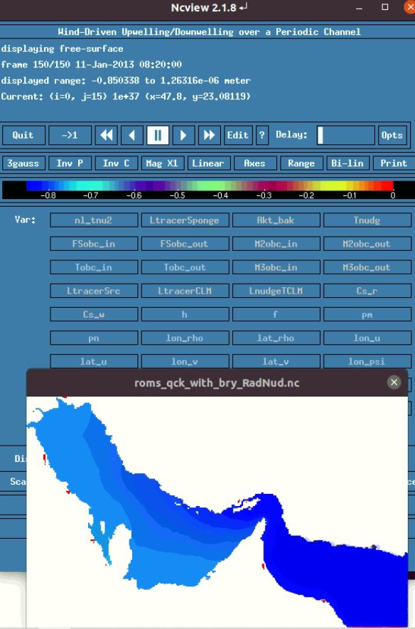

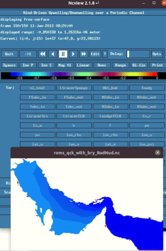

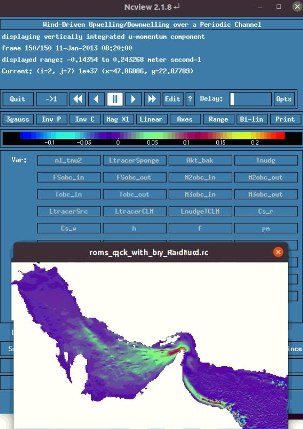

Based on the results, I decided to give the ERA5 information to the model and activate BULK_FLUXE in the file header to see the changes in the zeta, ubar, and u parameters. Finally, with the assumptions of Clamped mode for free surface and Flather for all others modes, I encountered a maxspeed error on the first day of model operation. However, after this performance, I again considered all boundary modes as Rad, but again, I did not get the desired results.
ubar
ubar
free surface(zeta)
free surface(zeta)
free surface(wind-all-Rad).JPG (75.3 KiB) Viewed 45071 times
tide-Era5-allRad.log
logfile
(855.17 KiB) Downloaded 1311 times
Now I'm a little confused about what part of the model to focus on and think about improving it! Is the problem from the boundary file or in choosing the type of boundary?
According to the above description, if I use Rad, the boundary file will no longer be read by the model. Does this mean I do not need a border file? (however, I have only velocity data from TMD in my boundary.nc file)
Thank you for taking the time to read this issue.

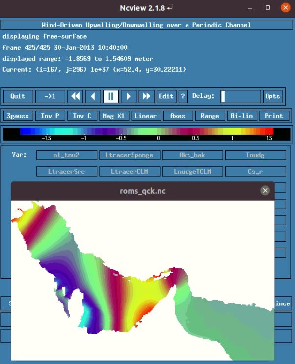

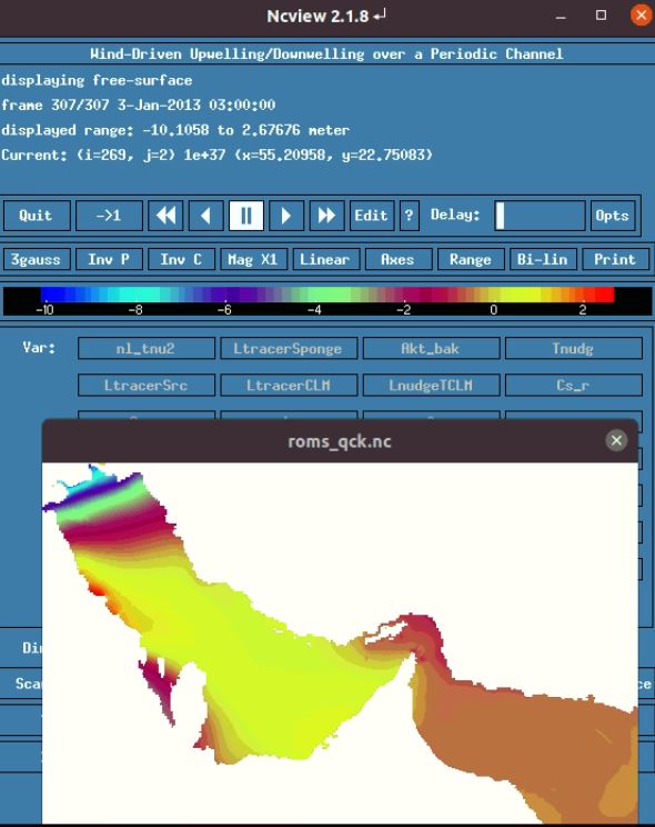

on this page, top figure, what is 'wrong' with the zeta?
AMIRHOSSEIN
Posts: 43
Joined: Tue Feb 11, 2020 6:03 pm
Location: IUST
Re: Different boundary scenarios
#5 Unread post by AMIRHOSSEIN »
Hi jcwarner, I am very thankful you are considering my problem.
I apologize for being late. Something was wrong with my laptop.
The problem with zeta is that after 11 days its amounts are very small. Before running the model in 3D, I ran it in 2D for 30 days
and zeta changes were between 2 to 2.3 meters(with the only tide as input). After that, I ran the in 3D(like in 2D) and zeta changes
were between 1.5 to 1.8 meters. finally, I defined BULK_FLUX and used Era5 data. As you see in the top figure, The zeta value should be
much higher than these values. shouldn't be?!

think you are changing too many things here.
ERA winds should not affect the tides. and dont rely on ncview to give you the max/min. click at a point and get a time series.
try this:
You have this:
zeta 1 Closed Radiation Radiation Closed
ubar 1 Closed Radiation Radiation Closed
vbar 1 Closed Radiation Radiation Closed
u 1 Closed Radiation Radiation Closed
v 1 Closed Radiation Radiation Closed
temp 1 Closed Closed Closed Closed
salt 1 Closed Closed Closed Closed
tke 1 Closed Radiation Radiation Closed
You need to use
zeta to be Chapman for all the open sides.
ubar and vbar to be Flather for all the open sides.
temp/salt should be nudged to something, or just set to Rad to start with.
set ndtfast to be 20
and give that a try.

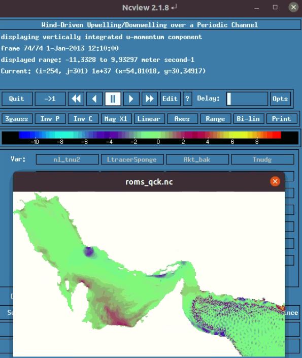

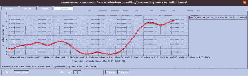

and here are zeta, ubar and u from ncview:
Time series near the Strait of Hormuz

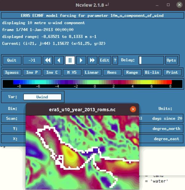

take a look at the winds in that ncviewer. how strong are they on the west side?
thank you for your reply jcwarner,
As you said for defining CURVGRID in the header file, the angle in my grid is zero, and is it still advisable to enable this option?
and u10 time series from my Era5 data in the west is shown here:
u10-domain
u10-domain
time-series-Uwind
time-series-Uwind

I am nots really sure what all to suggest here.
A few images back , you had zeta on the west side at -8m.
Can you figure out why that happened? Even a super strong wind would have trouble to do that.
I thought the winds might not be rotated to the grid correctly.
Suggest you set roms to write out the winds to its own netcdf output, and compare the winds in the roms his file to the winds in the ERA forcing file.

As jcwarner said, it was for the Era data, and it was because of the pressure that displayed 100 times larger in the ROMS output.
