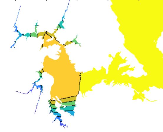

1. I totally forgot about this. Yet, from the very initial salinity field, NaN values have populated the land points. Below is what I mean, the snapshot of the initial salinity field, as it is, without any mask being applied (so the NaNs have been there from the very beginning). And so is the initial velocity field stored in the first history file (the first time layer in roms_his_0001.nc): seems like the stored versions of the variables have been masked before being written to nc file? Not sure if I've got anything wrong here, and not quite certain how I may check (without entering the debug mode) if any land points' values have turned NaN during the simulation.

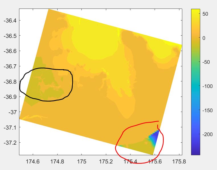

Also here, a snapshot of the bathymetry, without being masked:
The region-of-interest is in the black circle, and the very negative numbers are in the red circle, the two are very far-apart. The bathymetry in the black circle is based on nautical chart(s) and some LiDAR dataset, and I have made sure that the mountain range (Waitākere) has been smoothed out in the model. I will try if further removing the negative values in the lower right corner could really help...

I recommend that at all points in permanent land mask the depth be given a modest positive value so that they play nicely with adjacent wet point at the coast.

The _FillValue in output files converts the land point values to NaN when you read them into e.g. Matlab, but they are not NaN inside ROMS. So, yes, it can be hard to track. You might be able to circumvent the conversion to NaN by reading files with the lower level netcdf.open routines in Matlab, before _FillVale, add_offset and scale_factor are applied.

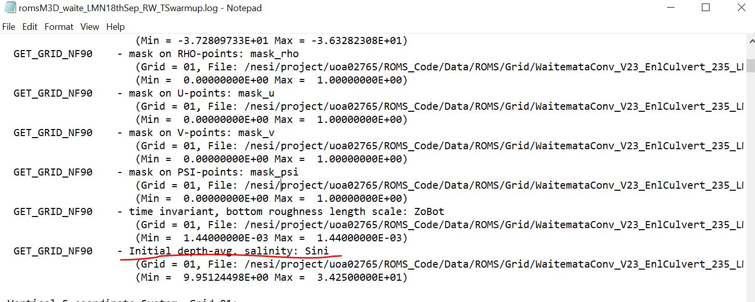

2. Aha, the story is like this. I decided to use the initial salinity field (representative of the April Waitematā) derived from some old reference and our regular monitoring. Yet the initial zeta and velocities are still set to zero (so I started out with the zero velocities and the estimate initial salinity field being the initial condition and did a warm-up run, with TS_FIXED; after a simulation of 10 days, when the residual current structure has been spun up for a spring-to-neap transition condition, I restart the model there). I did not want to prepare a large Initial file whose only spatially-varying variable is salt, so I hacked the ROMS code a bit, to make the ANA_INITIAL.h set initial zeta and velocities to zero, yet read the initial salinity field from file (the attached figure shows that the warm-up model reads in an extra variable Sini from my grid file). I thought here could be some bizarre values in my Sini variable and the wetting and drying, yet after checking I have confirmed this is not the case.

Thanks to Dr. Wilkin's suggestions, I have solved this issue. It was indeed due to some errors in my initial salinity field. After interpolation, I forgot to set the land point values to _FillValue, which later on caused troubles at some land points.... Case closed :D
